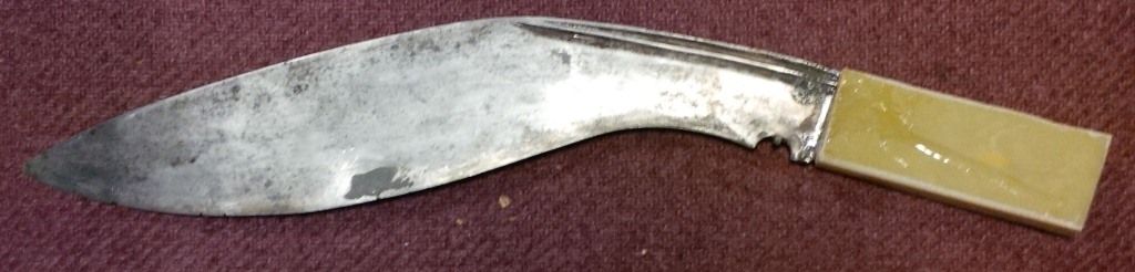

Back to the Bhojpure, I just finished shaping the hole for the tang. I filed the edges of the tang a little so they wouldn't punch through the laminations as ndoghouse suggested, hopefully that will help. Now I'm just waiting for the acraglas to set, once it does I'll roughly shape the handle. Assuming it holds up better than the last handle after chopping/batoning, I'll take more time to shape it nicely and polish it and whatnot.

Back to the bhojpure... so far the hardest part of the entire project has been NOT messing with it while the epoxy fully dries. I'm going to wait a few more days until I try it out. I think my previous handle failed primarily because the epoxy gave out. Had the epoxy held I believe the wood wouldn't have cracked.
I'm going to do some basic shaping of the handle next. So far so good!
The handle's rectangular and not barrel shaped so I can't do a traditional khuk handle. I think I'll just go with your standard American knife handle shape.
I usually don't become attached to inanimate objects, but after all the work I've done on this thing I decided to name this khuk. I dub thee AWATH, which is short for Accident WAiting To Happen.
AWATH. Ha! Love it! Let hope it dont tho:thumbup: looks like you got plenty of meat around the bolster area so shouldnt crack there. You get that much work into something and it makes for interesting testing! How thick is that piece of G10? Looks like about half inch?

It's 3/4th of an inch, which should hopefully be sufficient. I've been using her to chop at an old broomstick, and any where I feel the handle digging into my hand I'm grinding down with the dremel and a file. I think this should fit it exactly to my hand, but I have no idea what shape it'll end up taking.

I took Awath out for a little test drive today. The handle's still really uncomfortable, so I was only able to get through half the log this time.
Other than being uncomfortable, the handle held up just fine. No signs of distress or cracking. So on to "the widowmaker", batoning fire wood
I've never had such a hard time batoning firewood, the edge geometry on this blade is really not suited for it. But the handle's still rock solid. In fact, looking at the thing I felt stupid for even thinking I could break this handle even if I wanted to. So next step is making the handle more comfortable.
I think id call that a total success! The rest is details! Nice job BL. Hows the blade edge holding up?
I was about to say "the edge held up fine" but then I took a closer look and noticed two new divots in the edge around the sweet spot. I assume they're from batoning through knots in that firewood. I'm going to try to grind them mostly out, but I think this steel is just too soft for general purpose use. It's good enough for around the yard work, but I'd never put myself in a situation where I'd have to rely on the steel to stand up to any abuse.

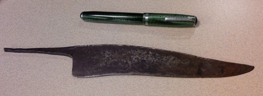

On a happier note, my Kerala blade just showed up!
It's a bit smaller than I expected, but I like it. It's dull as hell but I don't see any chips, dings, or flaws in the steel. I think this looks like an extremely useful general purpose blade shape. The tip is a little upswept for stabbing, the front of the blade has a little belly to it for slicing, the middle is a little concaved like a khukri so you could use it like a draw knife, and then there's another belly towards the tang for doing whittling and whatnot. It also has a "T" shaped spine that I'm sure gives it a little extra strength without adding much extra weight. I don't know if any company in India still makes these, but I bet if Cold Steel or somebody made a cheapo version for 30 bucks or so they'd be very popular.
