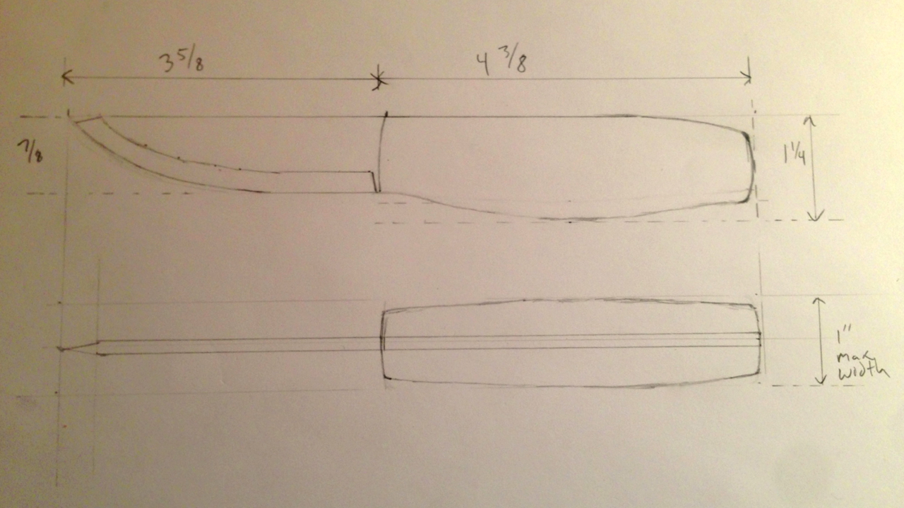

Here's a VERY rough sketch of what I had in mind. I'm going to work on refining it and see if it's something I want built under the Customer Designed Knife concept if John would accept it. I'm guessing the handle thickness would be an extra charge since it's wider than normal.
Overall Length: 8"
Max Height: 1 1/4"
Thickness: 1/8" O1
Blade Length: 3 5/8" (Would actually probably change this 3 1/2" so it would be under the Colorado knife length law)
Blade Height: 7/8"
Scandi Grind
Handle Length: 4 3/8"
Handle Height swells from 7/8" to 1 1/4" (Not sure if it swells too much)
Handle Width swells from 3/4" to 1"
Round Handle
I dig that but for me I would want a 4 inch blade. great design!
