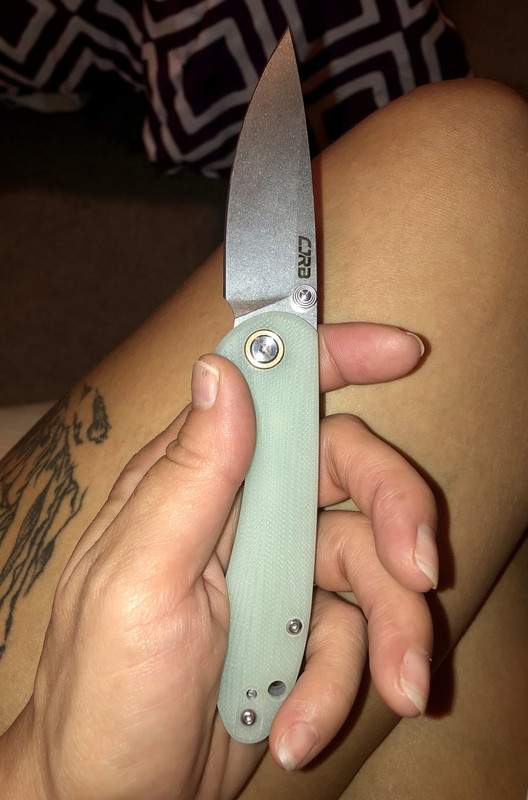

In that case, you would probably love the CJRB Feldspar.
