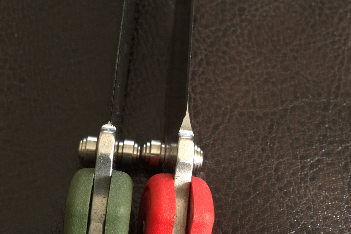

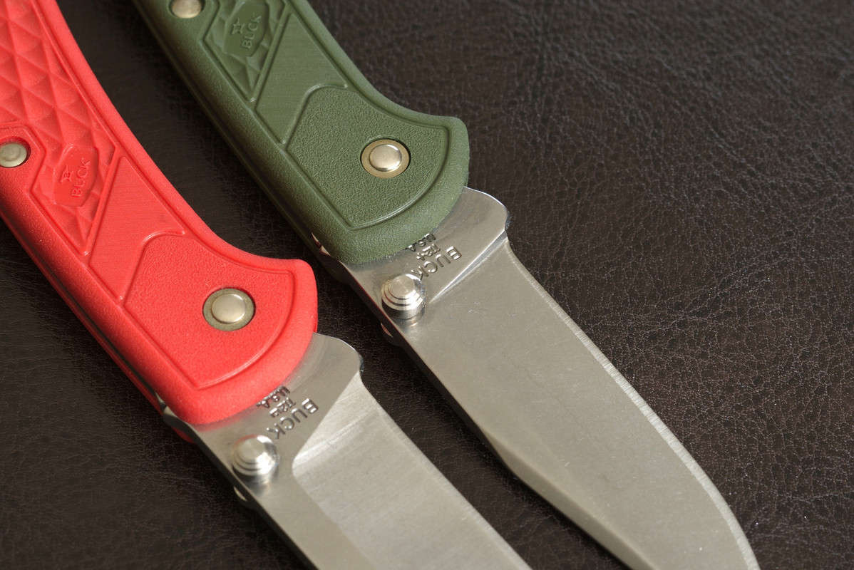

I've noticed a wide range of plunge grind angles and also some gouging into it during final edging at the factory. Here are two 112 Slim Selects that have very different grinds. The red one is actually a problem when trying to cut near the ricasso. I don't believe this can be corrected by any amount of sharpening or reprofiling. The green one is ground very thin behind the edge and is a wicked cutter.
