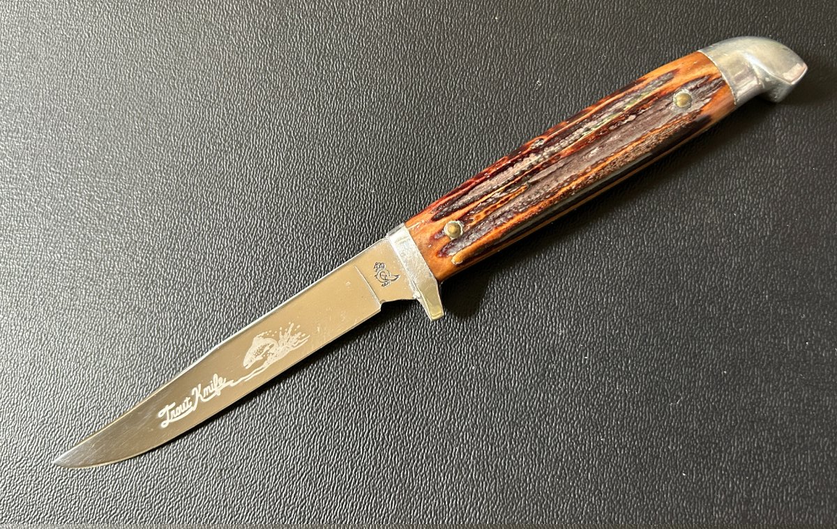

One I forgot I owned when I posted in this thread last summer - Queen Trout Knife.
