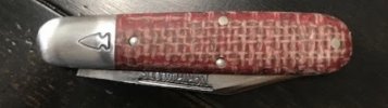

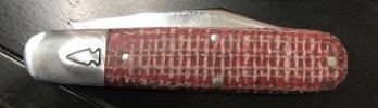

I recently bought a Big Bay of the Exchange in Red Burlap Micarta. It is a fine example of the knife, but I noticed today after having carried it awhile that there are some strange divots or voids showing up in the micarta. I am curious if anyone else has seen this sort of thing happening with Northwoods micarta (particularly burlap), and if there is anything I ought to do about it.
I've circled several examples of it. They are all over and in no order.
That's odd. You say they developed? Some form of degradation? But Micarta is tough stuff, possibly burlap 'weave' allows for shrink holes?

Well I didn't notice them when I got the knife, and I can feel the burlap from it being worn down from riding in my pocket (and perhaps in the Northwoods slip?). I don't think the voids were there when the seller sent me the knife.
I found the photos from the original seller. It is a user, so I pulled up the original seller's photos to see if the voids were visible on them.
I can't really tell, but maybe a few of them are. I PM'd the seller to see if he noticed them. I also sent a message to KSF to see what they think.

Micarta is a matrix held together by a binder that is thermally cured and pressed under heated platens...…. As the binder cures some outgassing occurs that causes small pimples, or voids...….. The size of the voids you show will have no ill affect on the material......
Looks like it may just be a cosmetic issue and not anything deteriorating.
Looks like tiny air pockets in the surface due to the curing process.
As you continue to get surface wear, others may likely appear?
You can use Elmer's white school glue (small dab & wet finger tip) to fill in the surface defects.
After it drys clear use 2000, 2500, 3000 etc sandpaper to smooth/polish the surface by hand.
The resin they use is likely similar to the resin used for cabochons (turquoise, lapis, coral etc).
It’s my understanding that it is just air pockets from not compacting the micarta enough when it’s made. It is more common in burlap because the looser weave traps more air.
