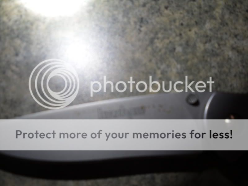

Here is the best pic I could muster. It still sucks, but it shows the rust, I think.
Sorry for the glare, this place is like a cave, so I had to utilize alternate lighting.

Mine rusted similar to yours. It is the blade and handle finish most likely. I ended up mirror polishing the blade and using the knife to practice filework.
ETA- Mine was from the early 2000's
It is in fact , the bead blast.
Rule of thumb , if you buy a bead blasted finish knife , polish it off quickly regardless of brand or face rust.
I despise bead blast finishes........

How do I, a poor college student, go about doing that? Sorry, I usually just leave my knives as I get them. Haven't gotten into polishing them and whatnot.
scotchbrite pad and some form of polishing compound and you'll be good to go.
if you have one, a dremel or similar rotary tool will make things easier.

Dougo, go to flitz and order a couple samples (free) from them. It takes a couple weeks for them to ship them to you, but then you can easily get off the rust.
Alternatively, if you can find bon-ami / comet, mix it with water to form a paste (on a paper towel) and polish it off.
Man this is easy stuff. AUS6, AUS8, S30V.. All of them, just put some WD40 on a rag and wipe your blades down once in awhile. Just some use once in awhile will get rid of rust like that. If the rag doesn't take it off use some WD40 and your fingernail.

Mothers mag wheel polish, Barkeepers friend, or even a pencil eraser should all work well.
Use Flitz. Mine developed rust from being EDCd, buat Flitz took care of it. :thumbup:

What solution for a poor college student....try some tooth paste on a soft cloth or paper towel.
