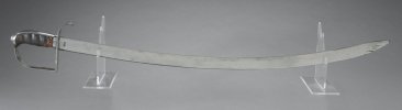

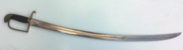

From an old (not too old) Heritage Auction listing
Exceedingly Rare Daniel Pettibone Cast Steel Horseman's Sabre Circa 1808-1812. In 1802 Daniel Pettibone, Ezekiel Chapman, and Josiah Nichols, Jr. were granted joint patent rights for a process of "welding Cast Steel to Iron, in such manner as to be applied to edge tools or other purposes where steel is required". In 1804, Pettibone, by changing the process of the original patent specification slightly but significantly, was able to obtain an improved patent and break from his joint patent holders. Pettibone sold licenses for his welding process throughout New England and the Middle Atlantic states. Research indicates that Pettibone was employed for a time at Springfield Armory and was also an arms inspector for the U. S. Philadelphia Armory. During the opening phase of the War of 1812 the War Department suffered from a shortage of swords. It may be at this critical time that Daniel Pettibone received a sabre contract and produced this example using his cast steel process.
This heavy sword features a 35" flat, curved, single-edged blade with riveted tang and clipped point. The blade width is 1½". The obverse ricasso features a stamped "U.S."; the reverse ricasso is die-struck "PETTIBONE'S PATENT / CAST-STEEL" surrounding a Federal-style eagle. The forged iron hilt features a knuckle guard slotted for a sword knot. Leather is stitched around a grip of cedar. This example retains about 80% of the original leather wrap. Though the blade markings are strong and distinct, the blade has been buffed at some point in its life. Otherwise it is in very good condition.
