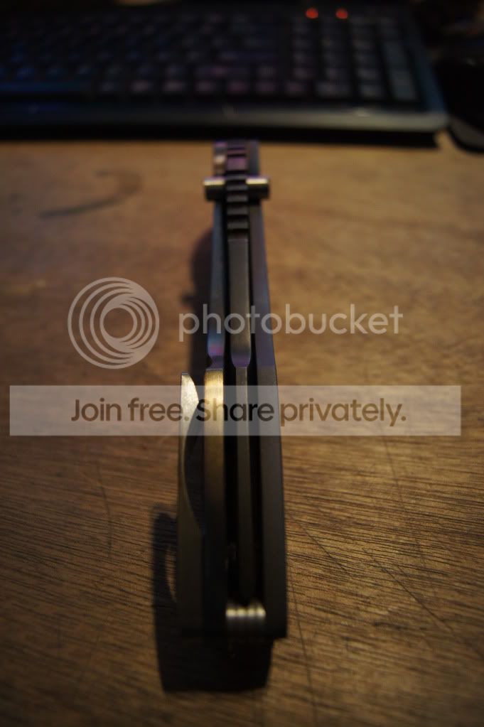

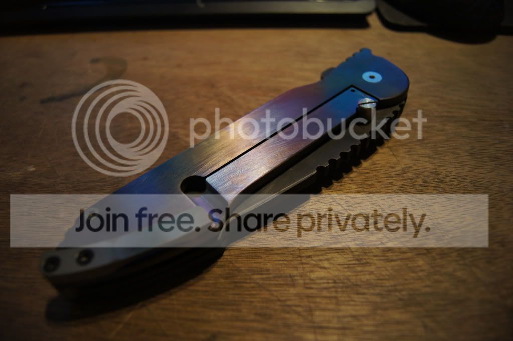

.030" just looks too riduculously paper thin to me on an overbuilt knife. Maybe I'm worrying for nothing.. I know I couldn't break it using a knife as a knife should be used, ie. cutting. I just feel like an 'overbuilt' knife, should be overbuilt in every aspect. What do you think?
