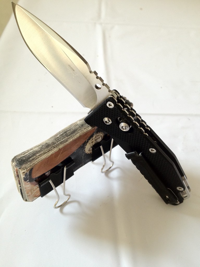

Thanks! Being lazy as I am, I tried stropping it on my 'makeshift paper wheel simulator' (read: manual rubbing end grain cardboard) that has some white compound on it, and it immediately improved!

Thank you. A poor mans paper wheel (inspired by it actually).
This is the endgrain strop. Long before Luong introduced his balance strop.
