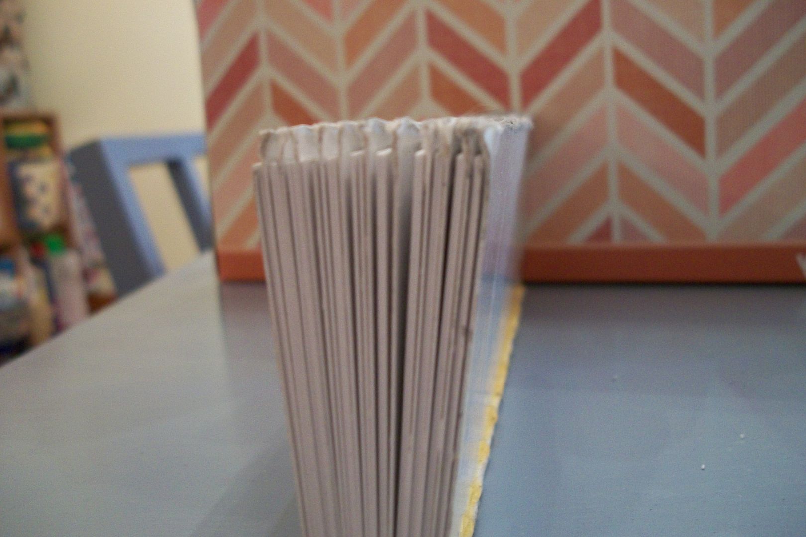

Here's another one I made from card stock, cut every third sheet a little short. Is specifically for doing serrations, the tips track between the high cards and it reduces rounding of the teeth. The high points track in the scallops and do a pretty good job of finishing em off, both sides. Cannot do anything more than touchups though, I use a DMT tapered rod for any actual grinding/repair.

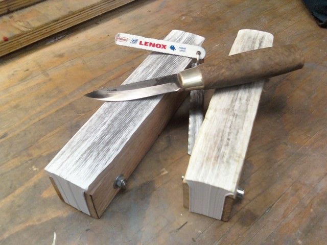

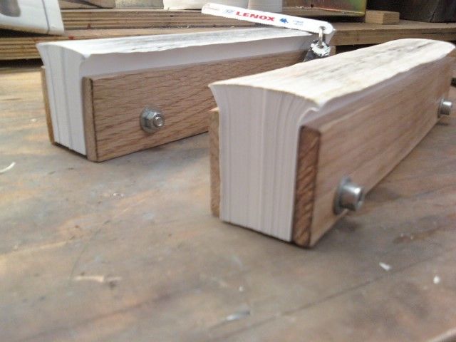

Here's what I made today. I had thought to make it along the length wise dimension but the bars I found were not long enough. The next longer one I found online was 20 inches which might be too long and unwieldy. My thought is if I wear this side down then I can get to the point where I could switch to the long side.
I just tried the knife I use as a letter opener and it worked really well in "sharpening" it. But my thought still is to use it as a "deburrer" in that it shouldn't affect the blade itself with the slight give of the paper but as I swipe the edge diagonally, the edges riffling will take away the burr.
