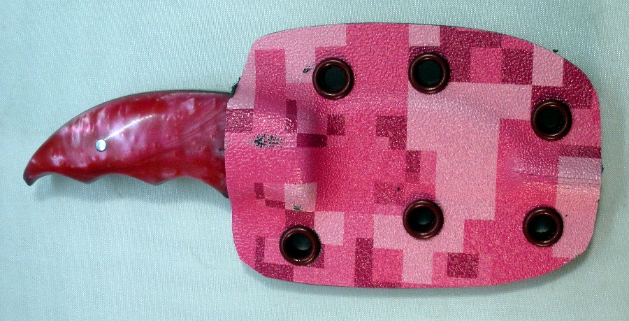

This morning before the sun came up I made the sheath. As expected, it did not damage the PolyPearl handle, and for that I was pleased. I was also pleased with the way the blood red grommets look against the sheath. And I like the way the knife clicks in and out of the sheath.
I was not so pleased to see that some of the digital camo coloration got ruined. Nor was I pleased with the placement of the rivet holes. And if I'm honest, I think the dowel I used to make the drain hole was too large. All that said, I have more of the pink camo kydex left, and I'll probably make a second sheath to try to address the problems.
What happened to the camo?
I usually keep the rivet holes as far out as the furthest one. Like how where your ricasso rivet is, bring that middle one down, especially on a hawkbill or curved blade.

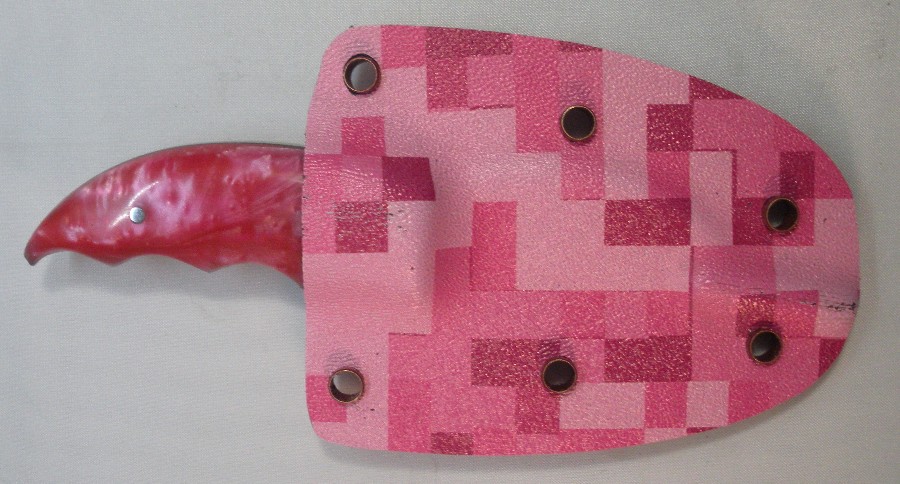

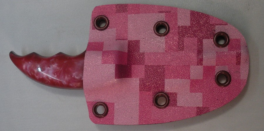

Attempt #2. Much better, but still not perfect. In this case, however, I think it will be good enough. Very little discoloration of the pink pattern.
Rivet spacing on round two looks much better. I'm not sure there really is a perfect with kydex, at least I've never accomplished such ;) but I think that came out nice and she'll be real happy with it.
