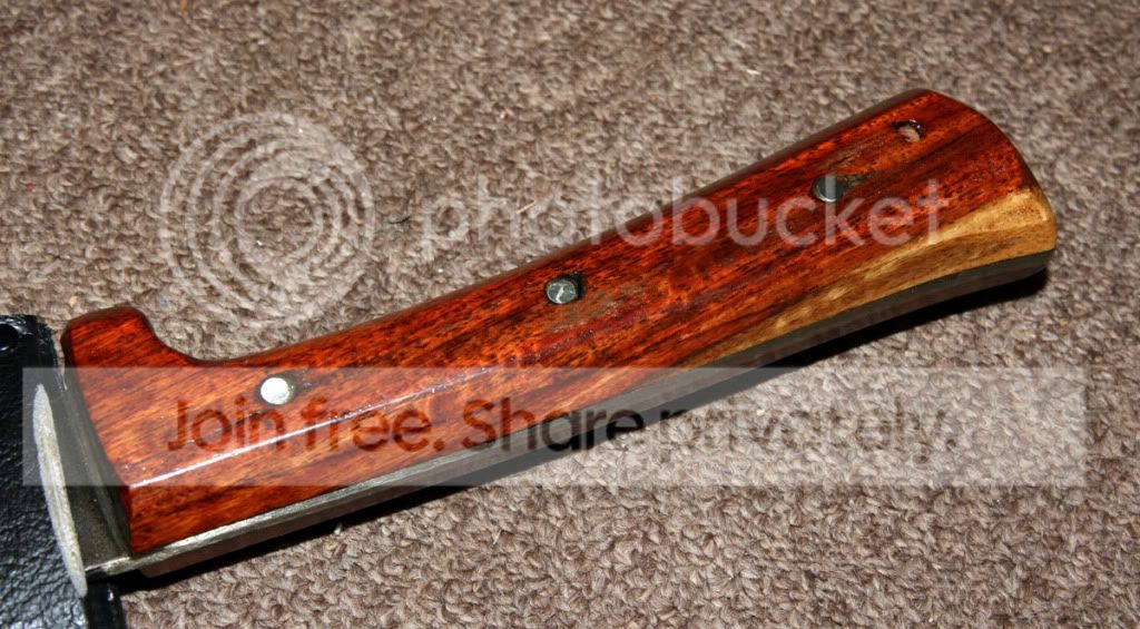

I'm looking for a clear coating for wood handles that will completely seal
them and provide a wear surface that isn't wood. the only thing I've done
so far is on a Siamese rosewood handle refinish/reshaping project, where
I used what I had on hand - McCloskey marine Spar Varnish in satin finish.
I assumed that being a marine varnish it would hold up to environmental
changes and wear. but when I started thinking about it, I started to
wonder about the biocompatability of varnishes and lacquer's in general
since they are next to the hand and covered in sweat for (at times) long
periods. what is the difference between wiping, alkyd, phenolic and
polyurethane varnishes as they relate to and knife handles? are any of them
not safe for use in long term skin contact situations?
what is the most complete protection for wood handles that is
biocompatable?
(the marine varnish handle:
a nice tacky finish)

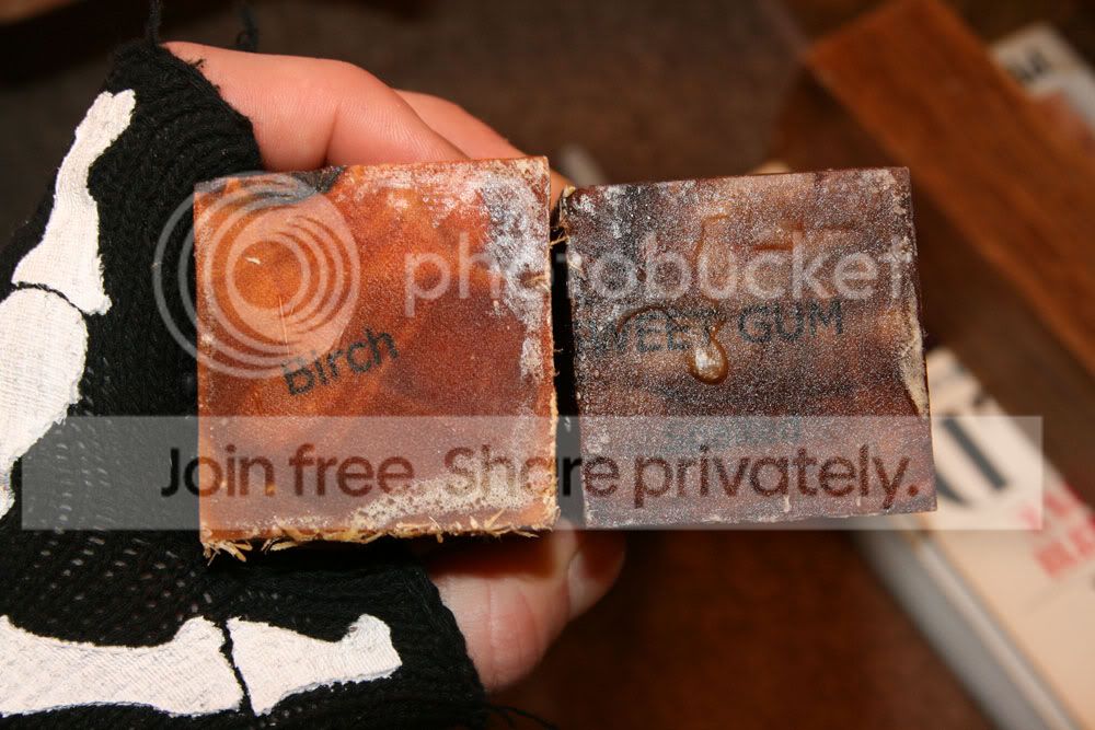

do beetles eat wood or live in it? after letting some beech sit seperated and
sealed in a box away from the rest of my stock because it had worm holes in
it from the seller, I found that there was at least one beetle present (which I
squished). very small, but I was curious whether it was eating it, or
burrowing, because if the beetles are eating it it's kinda pointless just to
quarantine it, I'd rather actively seek the bugs out to stop them from living
there permanently.

I think you'll find that few makers use clear coat on knife handles (with the exception of cyanoacrylate). Most times you want to preserve the look and feel of the wood. For this, a penetrating oil works very well to protect and preserve the wood.
If you are worried about durability (especially for softer species), stabilization (resin impregnation) is the best bet.
For shock resistance, nothing beats Lignum Vitae (Guaiacum sp.). The interlocking grain is incredibly tough. It is even used for mallet heads and bearings. You'll pay a pretty penny for something as large as an axe handle, though (and it would be heavy as hell).
Phillip
I choose between three finishes, for a chopper or handle that will be used alot and maybe sweaty I use oil, teak generally, tung sometimes and boiled linseed sometimes. Teak seems to penetrate more, tung better looking, boiled linseed a harder surface finish.
If it is a folder or small knife that will not be handled for long periods of time I use Hut Crystal Coat, you melt it on with a buffer and its a real hard finish mixture of shellac, wax and alcohol.
for just looks I use a wipe on polyurthane, I don't trust this to be a good working finish but sure looks good.
All are done in at least 3 coats or more
for high shock handles I first would choose desert ironwood, as the name implies there is no tougher. I believe it performs well in all these areas "Weight, Hardness, Stiffness, Strength, bending, Shock resistance, Decay resistance,
and Stability".. I usually only do desert ironwood in a teak oil finish.

When I get new wood handled farm, yard and construction tools one of the first things I often do is sand the finish off the handles so it won't be so slippery to hold and swing. I usually replace it with boiled linseed oil and include regular maintenance in the tools' care. I approach the issue in a similar manner as I do my leather boots.
Funny! that is exactly what i do! i hate the varnish finish on tools! especially on axes and hammers! it is to "sticky" and rubs blisters quick! i like my axe to slide! but i will actually leave them raw on occasion, and don't have them on a maintenance schedule :)
my recommendation is go with hickory. cheap, easy to find and TOUGH! as for the finish, i would go with a couple coats of teak, and finish it off with some boiled linseed. you can mix the linseed with some gum turpentine to get it to penetrate better. i did our oak front door with it, and it is holding up great!

Your beetle are living in and eating your wood. There are a few ways to get rid of them, Soak your wood in acetone, this will kill them. Put your wood in a microwave for about a minute. This will pop them like popcorn and kill them also. The microwave may cause other problems with moisture as can the acetone if you have a bleeding wood. If you use Nelsonite or resolute to stabilize your wood, soak it for a couple of days. This will kill them also even better draw a vacuum and stabilize and you'll really get em.

for the beetle/s, would getting a syringe and force pushing acetone into the open tunnels do the trick, instead of soaking the entire 4x4x12" peice of beech?
Tough, shock resistant handle? Use either hickory
or white ash (used for baseball bats). For finish,
I've used waterlox for 30 years on furniture, handles,
and darn near every thing else. It works well, is easy
to use, repairs and renews well, and won't raise
blisters on your hands.
Hope this helps.
Bill

I use min-wax wipe on poly on all the turkey calls I make. If you are going to use hickory I would I highly reccomend the min-wax. If you really look around you can find some really nice pieces of hickory. I got hold of some fiddleback hickory.Awesome some of the best looking calls I've ever made. Gonna use some for knife handles on the next knife I make.

The syringe method would not be completely effective. Are you going to cut the wood into handle blocks or scales?? I have also put some of my handle material into a sealed container with a box of mothballs in it. This would probably work though I did it as a preventative rather than extermination.
the culprits. from internet searches, these look like powderpost beetles...
How would I go about doing an acetone bath? would I literally have to put the stock
(the beech is big at 4x4x12) into a bath of acetone, or could I wrap an acetone soaked
rag around it?
one of the suggestions for infestation of cabins is to use a sealer all around the wood,
which interupts the next generation of beetles from forming... since the lifespan is roughly
9-12 months, I may just let this sit in a sealed condition for a year or two.
the effected stock
the stock is going through lots of shrinkage. it may not be easy to see, but these were
originally square and are now shringing tangentially (? if looking at the end grain with the
rings running left to right, it's shrinking inward horizontally) on the inside ring side. I'm
thinking that I'm just gonna let these sit and season for while.
i like the looks of the waterlox marine sealer and finish set, though I'll have to wait a few
paychecks before I can afford both.
and I'm going to go ahead and not order anything from them again.
We had a lot of powder post beetle issues on our farm. A borax spray is supposed to help. The product around here is called Hibor, not sure about by you. Its a standard wood treatment and preservative. You need to kill them little buggas (larvae) off as they can eat away at your wood for months and months.
would there be any negative effects on the wood if I covered them in a water and borax solution? I ask because timbor, a borax insecticide is pure borax. the instructions are to slather the wood in a 10% solution twice, and inject it into the insect galleries.
if I were to do this 3 or 4 times, then seal it, would there be any negative effects on the wood from the borax salt?
http://www.livingwithbugs.com/timbor.html
