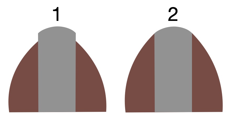

Does it protrude like the pic on the left or the right? Or something else?
The one on the right doesn’t “protrude”. It’s blended into the handle at least. Stuff like pic #1 is an automatic nope for me.

I understood it as more of a blend of the two. Not as pronounced as #1, but more like a slightly pushed out #2. Like a Chris Reeve Green Beret but even less proud of the scales. We’re talking about a radiused 48/1000” spread out over .22 width.
Here is .048 in relation to a Bic ballpoint pen. Imagine the height of a ballpoint pen, but .22 wide. If there was ever a case of mountains made out of molehills, this would be it.
The enhanced CNC abilities Jerry refers to allow for a precise fit of the edge of the scales to the tangent of the round edge of the tang, thereby eliminating the time and cost of individually hand fitting the tang of every knife to it’s scales. And this is apparently even less of a difference between the edge of scale and tang radius than the TGULB. All this bench racing over less than .050 of radiused protrusion (if the tang was left square and stuck out .050, I’d be in the other camp) is going to be proven to be irrelevant when JH10 hits customers and gets put to use. AntDog AntDog , if you get one, and can convince me that it’s legitimately causing you an issue during use, not just finger f***ing it on the couch, don’t even bother Jerry about it, I’ll trade you something out of my collection in exchange.
If pic 1 were an accurate representation I'd agree with you. Its not so much a protrusion as it is edge elimination. Its actually as flush as can be with an edgeless tang profile. Pic 2 isnt exactly right either but its closer, except that it should be shaped like the edge of a circle with a radius equal to the length of the knife.
Its actually pretty mind blowing what Jerry did here, imho.

This protruding tang isn't an "ill-fitted" protrusion, with sharp corners that'll dig into your hand. This will have the corners of the scales mate with the corners of the tang's radius. Not a tangential blend, but a mate. That means even if the scale gets knocked out of alignment, there are NO SHARP CORNERS. Just like the famed nuclear meltdown treatment.
