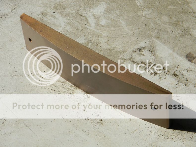

Radius platens simulate large wheels. They're called a "radius platen" because they're machined with a radius. The size number references the size wheel they simulate. So a 36" radius platen actually has an 18" radius. It simulates a 36" diameter wheel.
radius_platen.jpg~original
There are ten 36" platens, ten 48" and one 72".
Personally I like the 36" the best. 48" is the most popular. 72" is too subtle to really notice with your eyes and is mostly used by folks making certain kinds of kitchen knives.

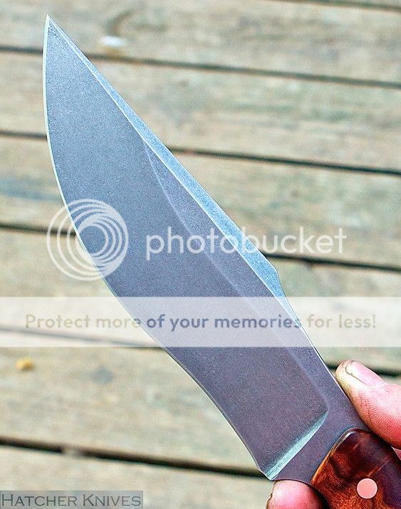

In using the radius platens I have found the effect is subtle, but noticeable. It isn't a flat grind, but it isn't really a hollow grind. I believe this is a historically accurate grind for blades ground in yesteryear on really big stones. I see this being a cool grind for blades made in an older style, and blades like kitchen knives where you would want a full height grind on a tall thin blade.

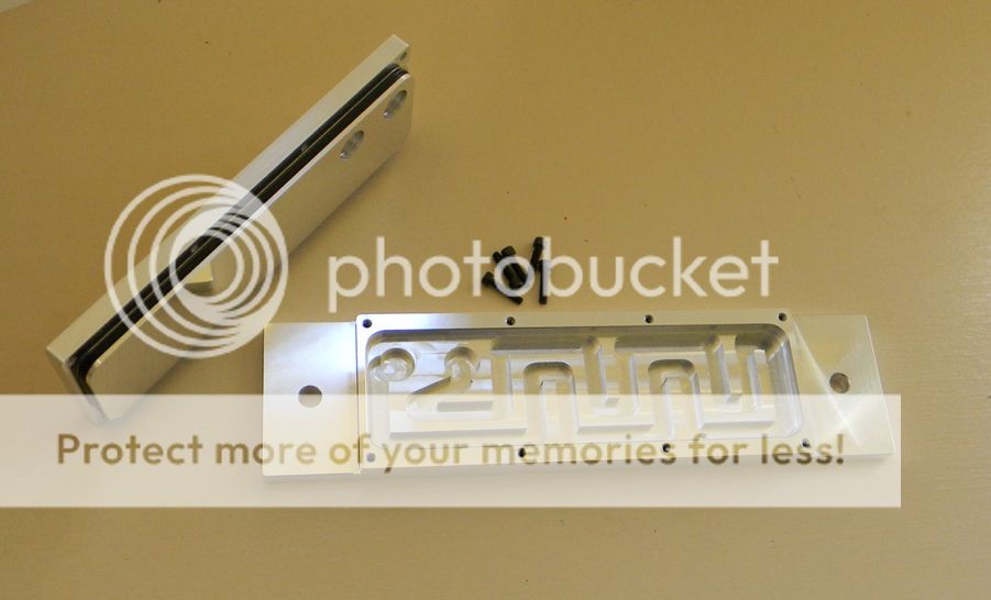

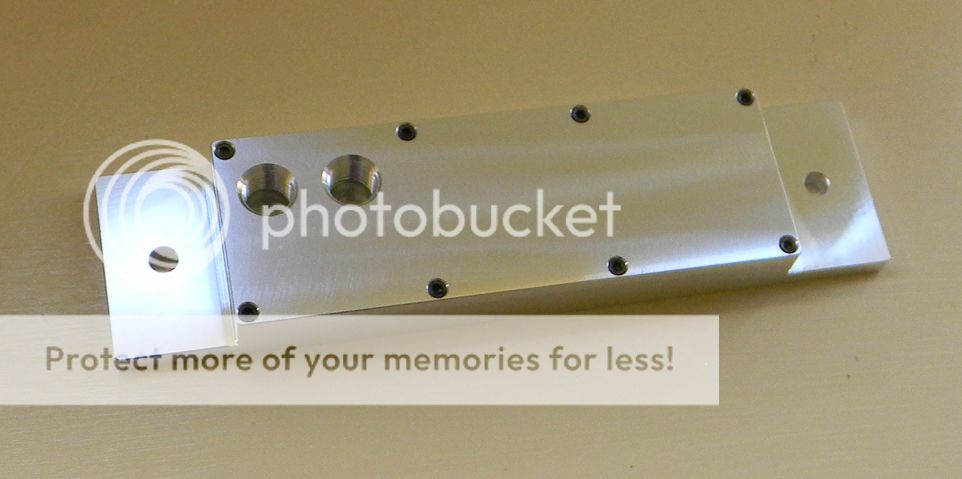

The water cooled platen chiller is a very useful gizmo. You just about need one if you're grinding with a belt warped around a formed platen, but even folks doing regular flat grinding have found these to be very useful. I've gotten a lot of great feedback about these and I use mine all the time and wouldn't want to be without it. Grinding against a cool platen is a good thing.
These have an internal meandering water path circuit where you can pump, siphon or otherwise flow water to control the temperature of your platen. I use ice water and get mine cold.
The mating surface is precision machined flat and the back of my steel platens are also precision machined flat so you can simply bolt these up and get fairly decent heat transfer. For better heat transfer or to use a platen I didn't manufacture you can use a little thermal grease during assembly to get really good heat transfer.
The chiller is sealed with a buna N o-ring that is rated to 250 F. The o-ring is compatible with water, antifreeze and most oils. It is not particularly compatible with acetone, so if you're planning to flow subzero acetone through it for use as frozen quench plates - you probably shouldn't. The assembly can be opened to remove clogs or replace the o-ring if necessary. If opened, you should use a little smear of grease to lubricate the o-ring upon reassembly.
The pipe thread is a standard 1/4 NPT. You are responsible for hooking up your own coolant supply. I recommend swivel push-to-connect fittings and 1/4" or 3/8" plastic tubing, though rubber hose and hose barbs work too. I'm using a dinky little centrifugal pump here and a bucket of water. The meandering coolant path in the platen chiller induces a lot of turbulence in the water flow which helps you get good heat extraction without needing a lot of water flow. An aquarium pump is adequate. Or you might opt to hook up to your regular water supply and simply dump the water (though you'll go to hell for wasting water). Just remember you don't need huge flow or pressure here. Keep up with your tubing to keep it out of the grinder wheels and mechanism using zip ties or similar.

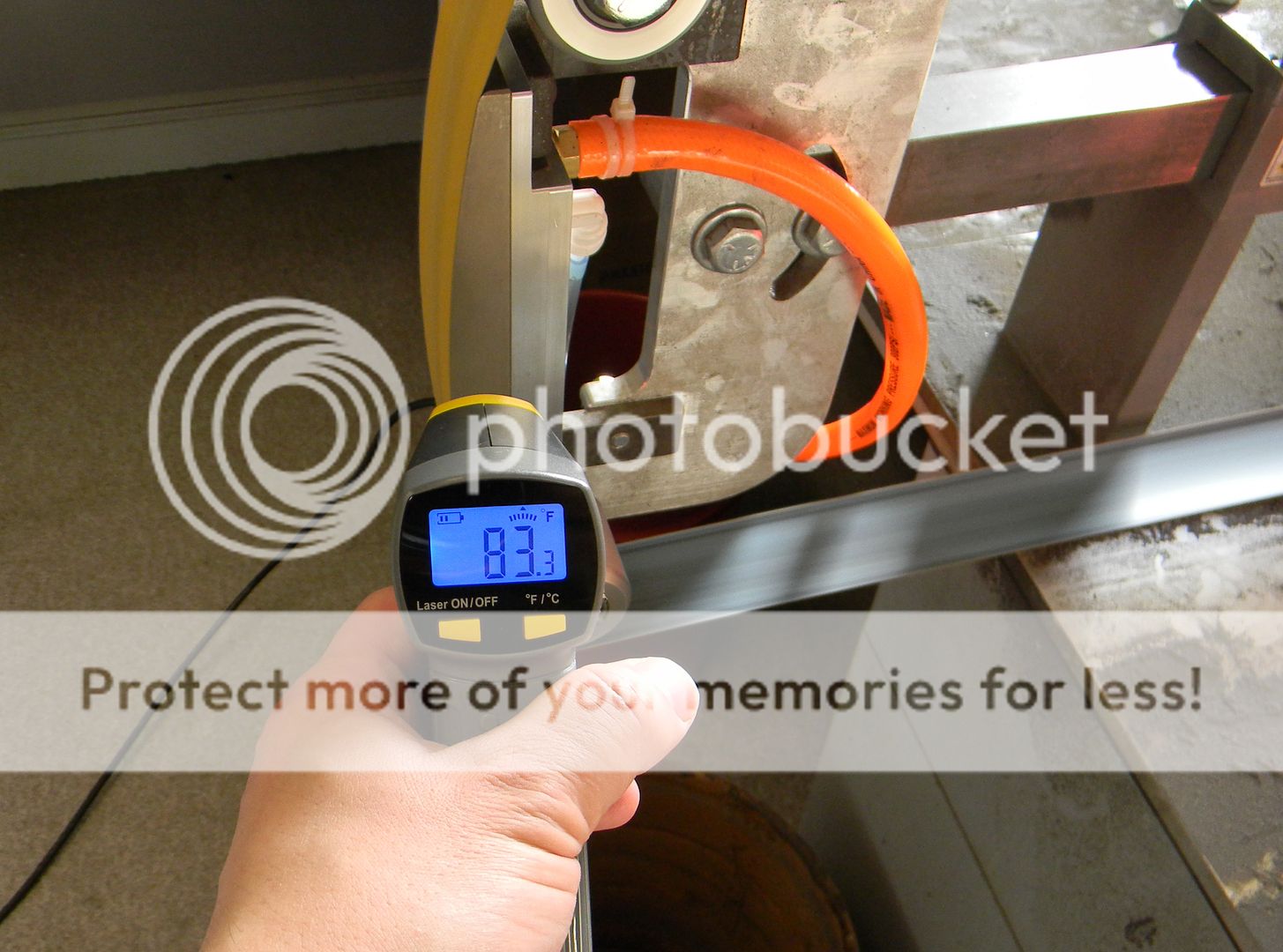

Put ice in your bucket for a cold platen. This can reduce your need to lift while grinding, particularly when using formed platens that can get extremely hot.

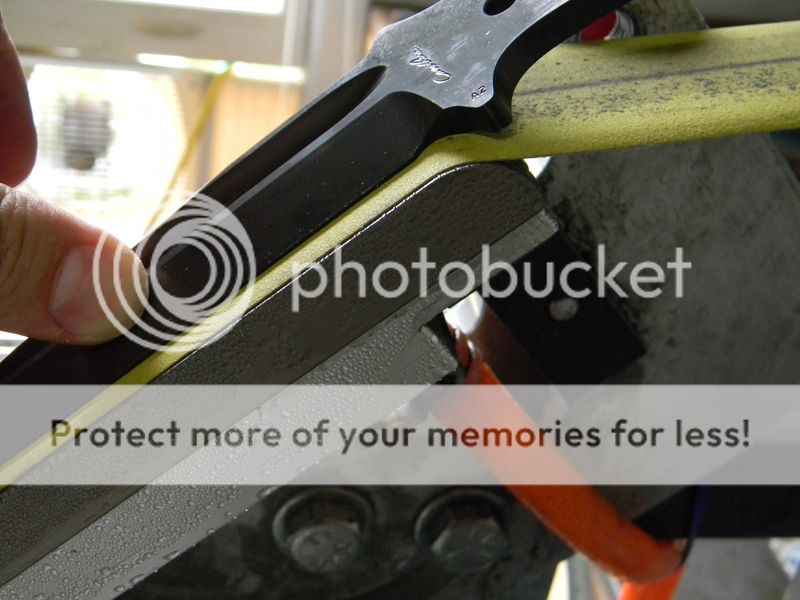

Grinding lengthwise generally involves removing the top roller from your platen attachment and draping the belt directly over the top of a shaped platen. I lean the platen back and run the grinder forward. Some people run it tip first and/or in reverse because there is less risk of slipping up and messing up your plunge but I learned to do it this way because I was concerned about catching the tip and getting hurt.
Running the belt directly over the platen generates a lot of heat. This increases your need to lift and dunk, and it gets hot enough to burn your belt. You need some way of cooling your platen. I suggest you make or buy a water cooled platen chiller.
The platen will wear. I only use it for finish grinding and I use it at low speed. There are some belts that build up sticky residue on the belt and platen that become loaded with grit and will eat up a platen. A damp belt can do this pretty bad. You should grind totally wet or totally dry to avoid problems and be on the look out for trouble.
Lengthwise grinding avoids the hot spots that bias the edges of a platen or wheel and allow a smoother more perfect geometry and the ability to have extremely clean plunges. In many cases it also eliminates the need to hand sand.
For the final finish pass I like to double up two belts so it has a bit of give. This will give you the smoothest most even finish. A clean 120 grit grind doesn't look rough and a clean 320 grit looks slick as hell.
I like the yellow Klingspor 312 J flex belts. Other belts I've tried tend to gouge and gall when a bit of grit pulls free. It goes without saying, use fresh belts.
In order to run two belts at the same time you're going to need to stretch a belt. Take a new belt and put it on the grinder under high tension and run it and get it soaking wet. Once it runs a little while it will stretch so you'll need to stop and pull your attachment out and run the tension up again. At this point it is stretched. You'll want to go ahead and rub the grit off the belt splice at this point to prevent splice bump from showing up in your finish. I use an old file. You can then take another belt like it that hasn't been stretched to run inside of it and they'll run together that way.
Like any new grinding technique there is a learning curve with lengthwise grinding, particularity if you're grinding like I do with the grinder running forward and tip down, standing to the side so you don't stand in line with a potential launch. You're probably going to slip and ruin a plunge before you get a feel for it.
You want to present the blade to the belt slightly edge first and out towards the belly. Roll it in, then roll it up. The mechanics are similar to regular grinding as you angle the blade out as you approach the tip. You'll want to stay away from the round over on the platen unless you're grinding your plunge. When you do grind your plunge you'll want a firm grip on things and press it in deliberately. Then roll the blade out towards the tip in one smooth deliberate motion hitting the entire length of the blade for an even finish.
