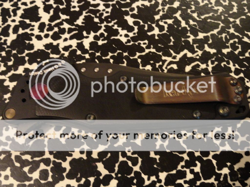

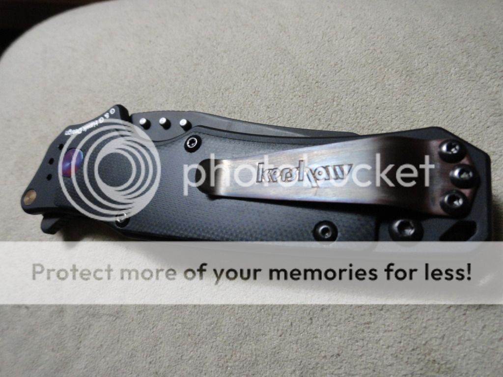

So i have been restoring an old rusty ontario machete my kids found and it was 100+ degrees today in my shop. So i got the mail this morning and there was a package from Kershawguy in the mail box. I ordered a ram blem to use and abuse since i had never owned one and always liked it. I decided since it was so hot outside to work in the cool basement on my new ram! this is what i have done so far.
I removed the g10 scales and sanded them down. They were too grippy for me and i had seen it done before somewhere around here!

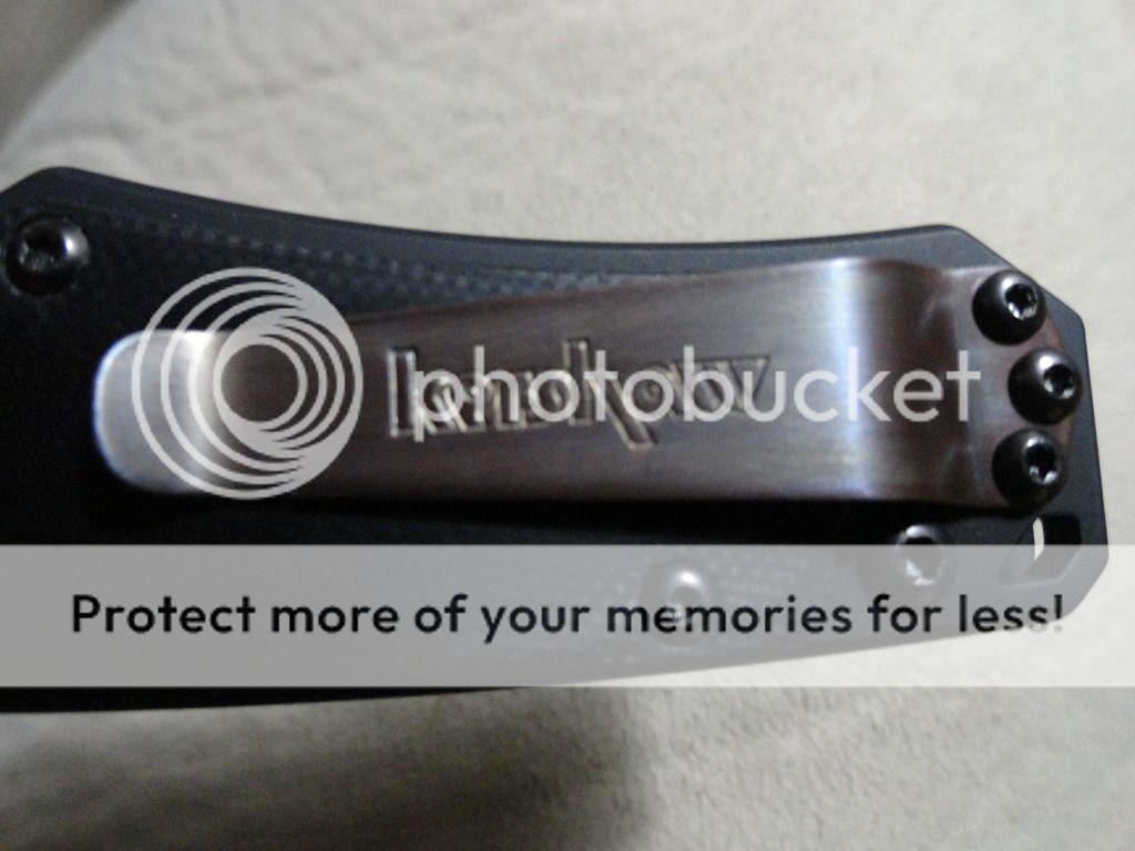

I also sanded down the clip and darkened/flamed it with a torch! Got a nice purple and gunmetal hue!

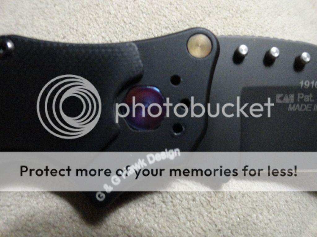

I took the stop bar and the hex piece of the pivot and flamed them too

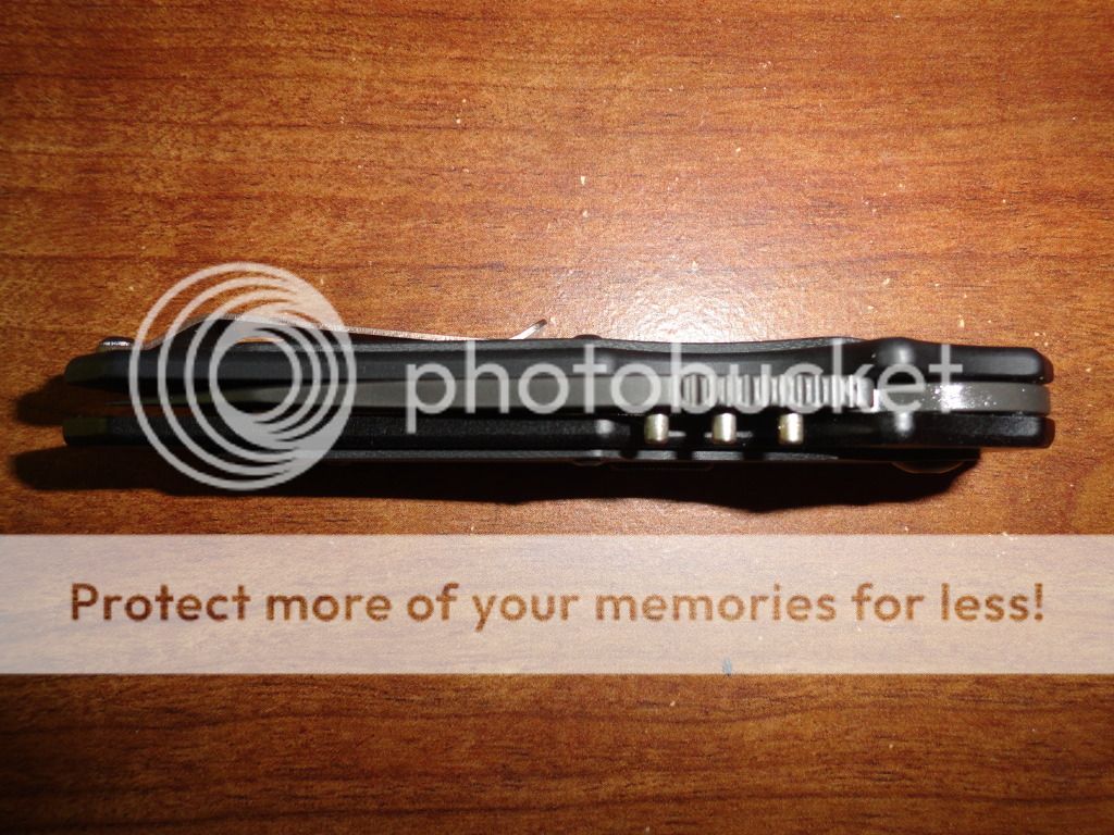

My question now is i would like to finish it off by flaming the three thumbstuds. How well does the dlc stand up to extreme heat/ torch flame? I would assume it would be just fine with no discoloration. Anyone have any experience with this and or anybody want to be a guinea pig and try it for me! Thanks in advance!

I tried to flame them but to no avail. I tried the ice water and it worked well to keep the blade parts that were under icy cool. The Dlc gets lighter in color when it is heated. I rubbed some oil on after the attempt. I worked it around and wiped it off and it seems to be pretty much gone with a slight hint of where it was but barely. So for anyone else wanting to know there you go. i might try to make a punch tomorrow to try and remove them. i have'nt made up my mind yet. I also flamed all the screws that were black. They turned a cool gray color.
side note: you can atually use the three studs as thumb studs now!
