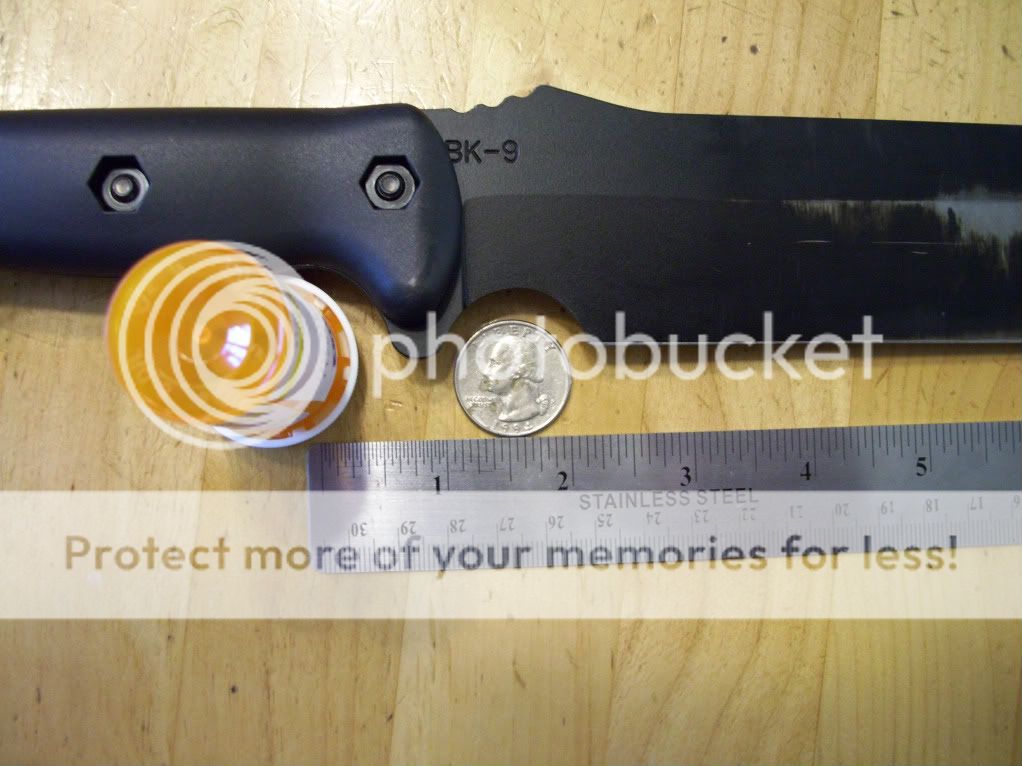

How did you add the choil? I thought you must have shortened the scales and moved them down but it doesn't appear that way and it doesn't look like you lessened the cutting edge either...I'm stumped:confused: Either way that thing is awesome. I might have to hire you to mod a BK7 that way for me;)

It's not real, I used the GIMP program to manipulate a photo. And thanks, appreciated.

Take your time. Buy a Dremel Tool. Take your time. I got the 4000 model, but any will prolly do. Take your time. Get the large grinding wheel (it is still small IMHO). Take your time. Get a spray bottle to fill with water. Go slow. I used a perscription bottle to trace around, for the choil, with a silver sharpie. Go slow. Get it right. Take your time. I taped the blade 2x with some Gorilla Tape (so you don't accidently cut yourself. I c-clamped it to the picnic table. Checked everything one last time & had at it. I used the grinder for about 10 seconds, then sprayed it with water, so it never got hot---at all, so the heat treat was not affected. I went slow & took my time. She ain't pretty, but that bitch is mine ! I LOVE it. The choil & jimping did NOT affect the fit in my custom sheath either.
Really, it is easy. I did not know shit from shineola just a year or so ago. This site---PARTICULARLY THE BECKER FORUM---IS AWESOME. GREAT PEOPLE, GREAT KNOWLEDGE, GREAT HUMOR. If you are a knife person, you really need a dremel tool, or something eqivelent.
I did the same thing and loved the result. Did it a little further back so my finger would not have to reach as far to get to the choil.

The thought behind the divot on the spine was to give the webbing on my right hand a place to sit comfortably when I choke up. I was inspired by a Ratmandu.
