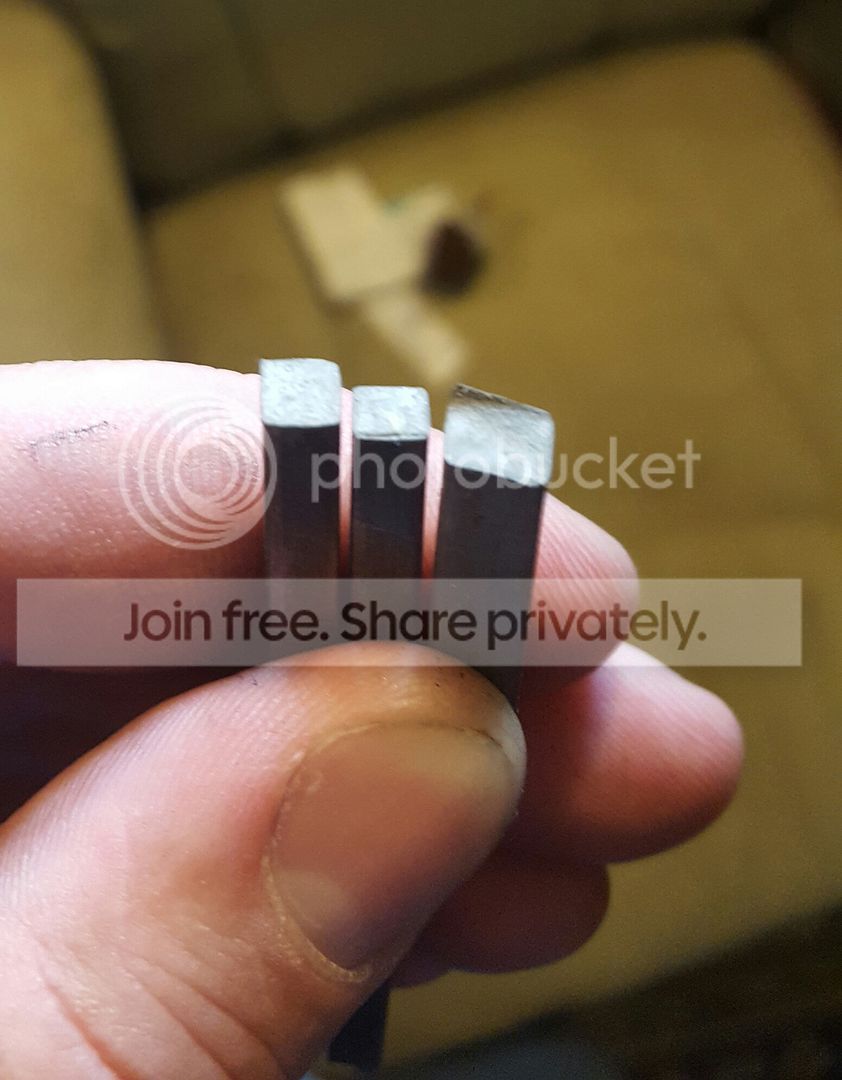

A few weeks ago an SCA friend of mine gave me a whole bunch of old style fencing foils and asked if I could make anything with them. I took them off her hands figuring worst case scenario I could use them as blacksmith stock.
So last weekend I had a spare few minutes and thought I'd do some quick down-and-dirty testing. I cut a few of the foils off about half way down their length where the stock is about a quarter inch square (give or take) for testing. A spark test produced a pretty solid amount of sparklers so I went on to a test harden. Heated them to non magnetic in the forge, held them for a few minutes, and did a quench in peanut oil. Nothing. Nada. File bit in and I could bend them right over with a hammer.
Okay... Lets try that again. Same process, but with a water quench this time. Huh... What do you know? Hardened up just fine this time...
Sorry for the out of focus pic. I was in a hurry and only had my cell phone.
So obviously a water hardening steel. The foils were all made in France. Anyone have any knowledge on what type of steel might have been used?

You know I never thought of welding the ends and making a billet. Hmmm... Very interesting idea.
As to steel type, that's what I expected them to be, a simple medium-high carbon steel, but them not hardening in oil has me confused.

A question for me ? As a fencer/metallurgist I was interested in sword steel and how and why they broke . Back in the '60s the blades were European made ,dirty steel [lots of inclusions ] and of 9260 .That's a spring steel like 5160. The typical foil had rectangular cross section with fairly sharp corners .I don't remember the hardness. Parries would put small nothes in the blade - nice stress concentrations ! Large inclusions also made stress concentrations! Dangers ?Many fencers didn't know the safety procedures -The instant you hit , relax your arm !!! Those are the reasons for failures . Somewhere along theline they decided to make swords ofMaraging steel. At that point I was already out of the fencing game .But I knew all about Maraging as my college thesis was the making of a maraging steel !

Oh these aren't wall hangers. they were used, and used heavily a couple of decades ago. I'm going to play with them a bit and see what I can come up with :)
Well, I whipped up a quick test piece yesterday. Basically I forged one piece flat and ground in into a rough chisel (about a 30 degree angle) Hardened it (again, no luck with oil, but it seem to harden fine in water) drew it back at about 450 degrees. Then sharpened it up and proceeded to beat the bejesus out of it. Chiseled quite a bit out of an old 2x4 with no perceptible dulling, then pounded it into a brass rod. No chipping, and no edge deformation that I could see with my naked eye.
I don't know what steel it is, but it sure seems to be functional in that limited application. Next project is forging out a small test blade to see how it'll do in a thinner form.

According to my research pretty much all modern foils are made of stuff called maraging steel, which I had to look up. It's basically a low carbon steel with lots of nickel. Not an acceptable blade steel, and not heat treatable using the methods common to bladesmithing. Wiki article on the subject https://en.wikipedia.org/wiki/Maraging_steel
These ones I'm working with appear to be old enough to still be made of more traditional carbon steel. Tough stuff, whatever it is.
It's NOT a carbon martensite !!! But it IS a martensite ! BTW my titanium gladius is also a martensite but not with carbon. " not an acceptable blade steel " ??? Then why are they using it ? You said that to the wrong guy !! I made my maraging steel forged it ,tested it , high strength , very tough fine for fencing !!! You need some metallurgy lessons !
