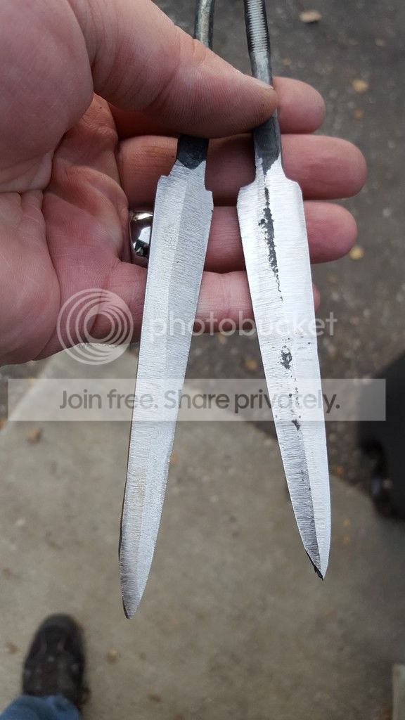

I finally had some more time to play in the shop over the long weekend. I'm still not sure what steel these are, but I've confirmed that they don't harden at all in oil, but harden up very nicely in water. I've decided to step out on a limb and try my hand at making double edged daggers from these foils. They'll be my first double-edged knives. Forged them out yesterday, and did a rough (very rough) initial grind before I had to pack it in for the day. I'll post updates as I get time to do more...
They should work fine for daggers. Daggers need to be tough, but edge retention isn't a big requirement.
