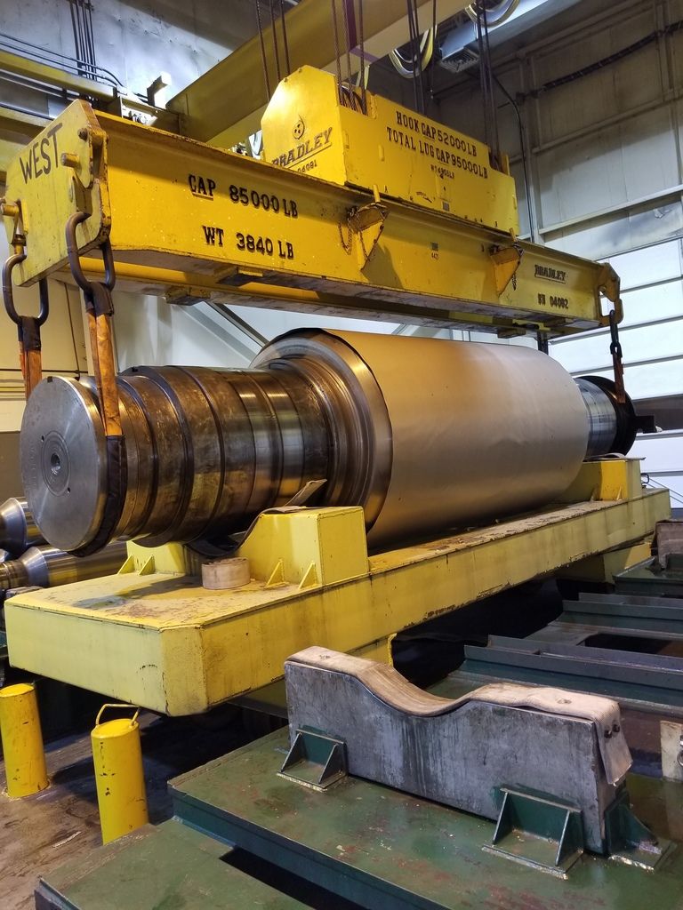

Aluminum rolling mill bottom backup roll. 40 tons.
I grind these to within a .0005 spec with a crown profile.
.0005? That is amazing. I was an apprentice tool and die maker for a couple of years in the early '60s. (I quit because I got tired of counting my fingers) . We were lucky to hold + or - .005" tolerances. Just before I quit the shop got a lathe with a led display. No one could get the thing to work and the company rep was there every day trying find out what was wrong with it.
They also had a Moore jig bore, but no one was allowed to use it. The boss was afraid that we might hurt it. :rolleyes:
Wow thats cool to hear.
The smaller rolls are within. 0002"
Some flat, some with .001" crown.
Some concave. Some grinding machines I operate are old mechanical, some are cnc.we use a (pro-micrometer) electronic unit with wheels to measure the roll specs from end to end. It calculates taper and profile center. Its very challenging because the roll can't have feedlines,chatter,pattern.
