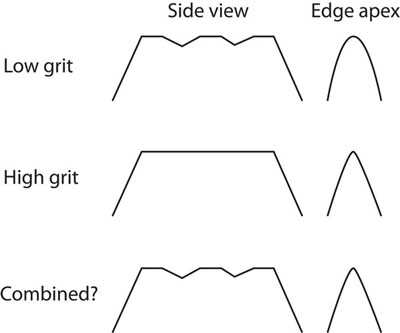

I guess my confusion stemmed on the definition of "soft and hard" materials. I would expect to see no difference in edge retention when cutting tofu between HC and LC blades. But then, Jean fabric is said to be hard enough to function as a strop. I consider it a soft material, but it is able to wear steels (although in this case it may be a lateral stress)......
So ... it seems like having "teeth" and a narrow apex at the same time would make the edge perfect for both slicing and push cutting with good edge retention, particularly with HC steels...
To test this, last night I sharpened my ATS-34 blade (20 DPS) with 250 to 8,000 grit stones with small increments in the grit #. It cuts a free-hanging hair and shaves well, but seems slipping on the skin of a tomato or on my palm skin. I then resharpened it with a 1,000 grit stone followed immediately by a 8,000 grit stone and stropping. It doesn't split free-hanging hair but shaves well and bites tomato skin quite well. I don't know about the edge retention yet.
I am sure that this kind of thing has been discussed somewhere in this forum. But I wonder whether this low grit to very high grit sharpening is commonly employed.
