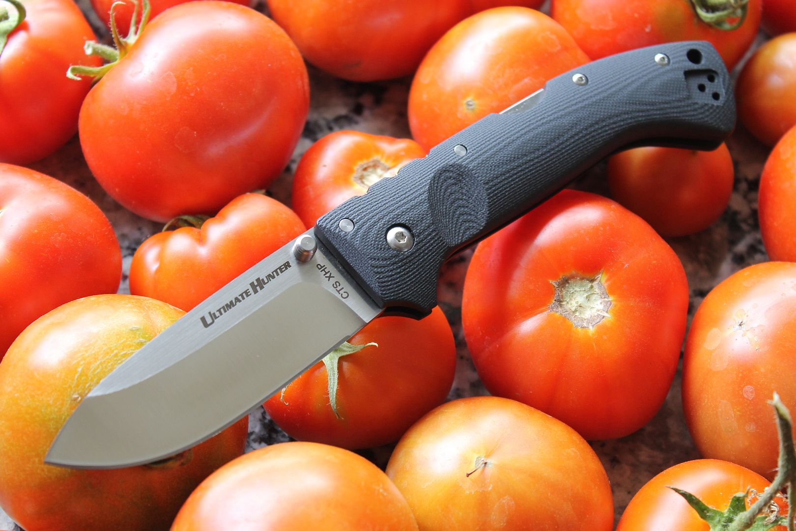

Should I think that CS is offering that knife at 63.5 on a daredevilling base?
The production companies have to be careful covered that one. :)

Wow, im surprised to see the CS knife at 63.5 hrc, especially when in most descriptions it said the range is 60-61. Id buy one in a minute if its 62 to 64 hrc like xhp shoube ran (been saing this for a while, same with s35vn) but is that the norm or was that a freak accident and they got a higher hrc than desired. I kniw most companies (microtech excluded, best s35vn I ever had was on my socoms) run their steel a few point lower and keep the grind at .020 and above which makes for a crappy knife for cuttinf but I guess you can pry open a tank with it. This is one of the biggest reasons im buying more midtechs and custom knives then production even though spyderco will always have a huge place in my heart. Andre Thorburn knives are made incredibly well and at a decent price but the best feature is out of 6 ive owned all were under .015 and most are at .012. Its a pleasure to work with such a well crafted knife. I recently got a Direware solo5, its been my dream knife for over 2 plus years and I knew I wanted one no matter that is a overbuilt knife. Well I was very pleasantly surprised when I got it to find the s110v blade ground to about .014 for most of the edge and thickened to around .020 at the tip which is good imo, its the wharncliff version btw. So if an "overbuilt" tacticool knife us ok being ground to under .015, why arent more edc knives? Microtech runs their steels hard, 60 to 62 hrc for s35vn and their grings are pretty lean and they seem to not llse money from blade replacement. I guess im not a ceo of a big company and I have to factor certain things in and cover my ass so blades dont break but on my beloved military and para2 the problem is the thin tip and I dont think an extra few points of hardness will make it that much more brittle but it will give a much better knive in return. Either bump up the hardness or thin out the grind, having both is overkill imo but what do I know?
1st CS folder for me in 20 years. Thanks for the tip Jim.
