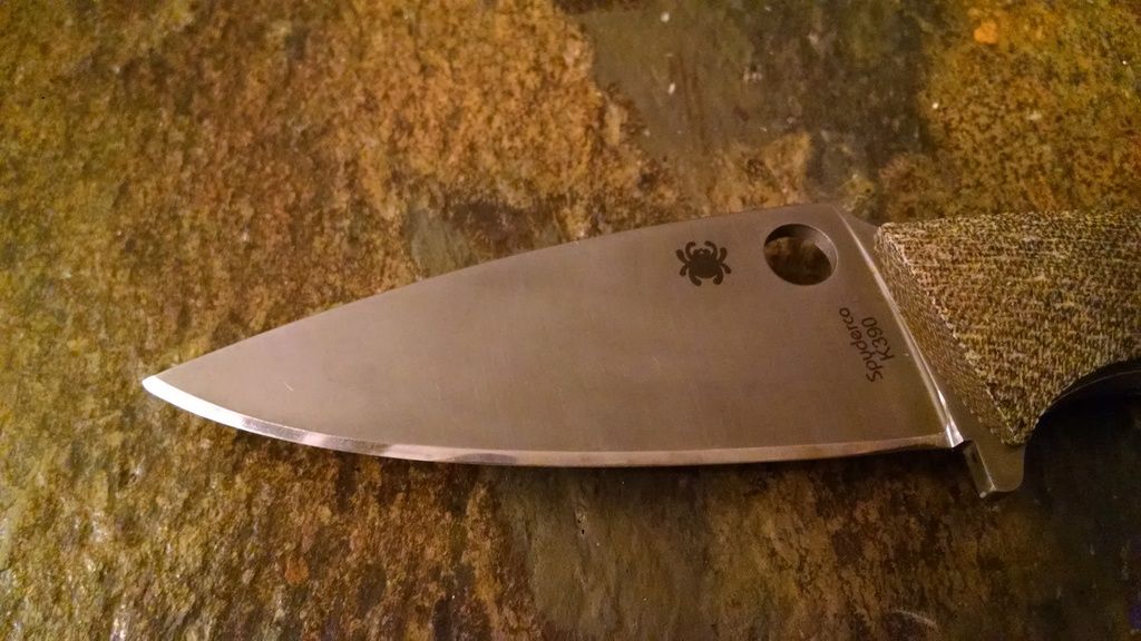

Would you like me to make a name (same I made to Phil Wilson, BTW)? BU K390. Great wear resistance (very close to CPM-10V), very good toughness that when both at 62HRC it is slightly superior to CPM-M4 (>42J), and corrosion resistance on par or superior to 3V (if K390 is austenitized > than 1150°C). Great overall balance.

uhhmm: I'd be entirely spoiled to learn the K390 Mule could potentially be in excess of real 63 and with deep cryo and proper heat treating, well, to be clear I had a glad departure from this brand :mad:
They failed doing i.e. on Dice/Domino/Techno blades what Cold Steel did with Ultimate Hunter at a fraction of cost.
