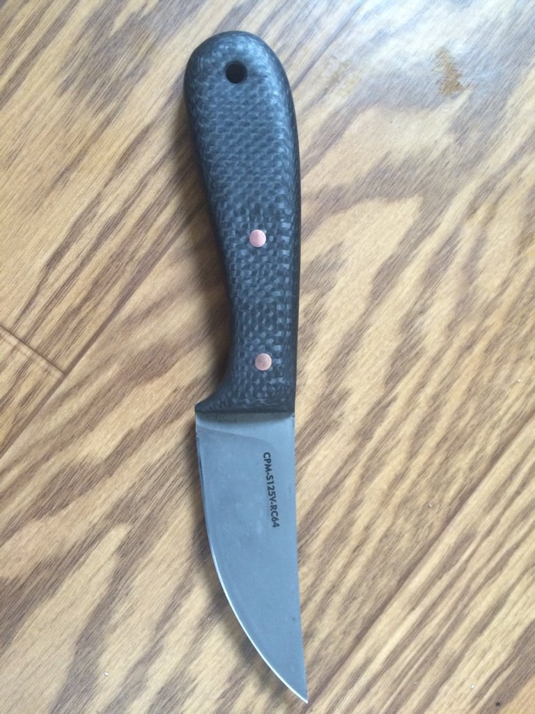

Early on you talked about testing the same steels at different hardnesses. I have a s125v full flat ground at 64 HRC after being tempered several times and .10 at the edge and I haven't put the bevel on it yet or the cf handle and .12 at the spine but I was wondering when I'm done with it if you would be interested in testing it to see what this steel will do at the extreme or at least close to it. I know this will take a lot of time and cutting so I didn't know if you wanted to take the time or even if you had the time. Thank you for your consideration. My email is martin238 at me dot com.
Jim,
I actually have one coming that's 64 and .006" behind the edge to test. :)

Always one up lol! I also have a Phil Wilson K390 Bow River at 64 .08 behind the bevel if your interested in that?
I showed you mine now show me yours.
In all seriousness I'd like to see a picture of it.
Got it in today for testing, will shoot a picture tomorrow and post it.
Going to do a full review on it. ;)
