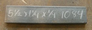

Hi folks well it's been awhile since I posted any pics so I thought I would do a thumb nail WIP on a little knife I have been working on. I needed to come up with a one day forged knife program, well actually, I had to do a small class in 3 hours for for our Blacksmith group and this is what I came up with. So, now I will show you how I make the Shop Rat Knife and I can make the knife, start to finish in 2 hours. its a fun little knife make & I would like to know if this is a knife you would buy. its a working knife and a little hip bling as well. I designed this knife to teach folks how to forge blades and to keep the fun in knife making and I would love to see any of you make a shop rat based on my WIP. In fact, I will give a D Lisch Shop Rat Knife to the first person to post their shop rat knife on this thread with a sphincter intact.

Get it all in line and clean the edge and it is ready to harden so I dial back the forge to around 1550 as I bring it up to heat if it looks like the tip is getting to hot I pull it out and rest it on the cold anvil
It got nice and hard

Stuart see # & 7 of this Thread I used the forge and my heat temp gun I tempered in my oven but when I did the class in 3 hours we tempered with the forge too. its a quick and dirty knife I plan on making a sheath for one and putting it to the real test everyday shop use I will show it on my hip when its done
I saw that Dave but I just didn't understand it. I've seen a video of a guy quenching a blade then placing the spine on a red hot piece of steel to temper it but like I said, I didn't understand the "cold anvil" approach, hence my comment about my ignorance. :)
Stuart The cold anvil was to keep the tip from getting to hot when you put the knife in the forge the tip gets hot first if it gets to hot you over shoot the temp so I cool just the tip a few times so the thicker part of the blade has a chance to heat up and the whole edge is at the right temp without tip being too hot
