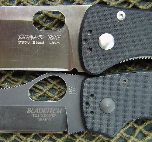

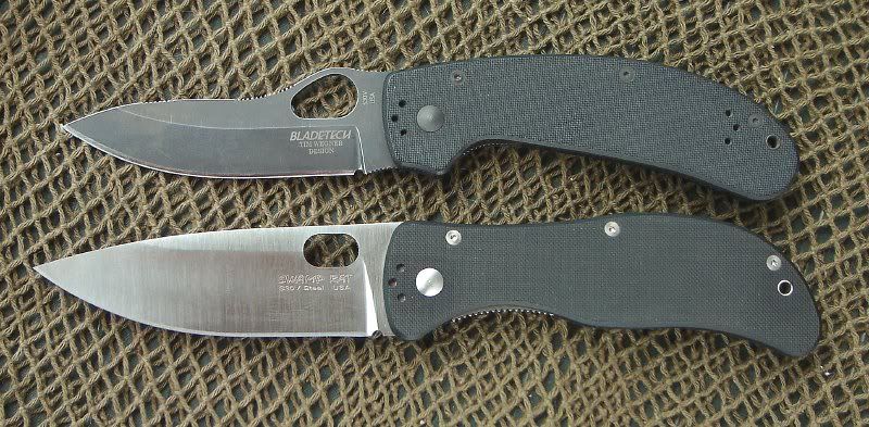

Go to the Blade Tech site and look at the Pro Hunters. Same clip, same scales, same fasteners in the same places. The Rat Trap is either made by Blade Tech or the same company made knives for Swamp Rat and Blade Tech, IMO.
I love my Rat Trap, by the way. I find myself carrying it more than all my other folders combined. Living in Alabama where people don't freak out over a 3.9" blade is a big plus, though.
There was a thread over on Rat Chat back in June '07 in which Martin had some comparison pics of the Trap and Blade Tech's Pro Hunter. The similarities are amazing. I just checked the thread and the pics are gone, but I have them saved if anyone would like to see them.
Oh, and I think the Rat Trap is the best folder for the money I've ever seen, and definitely the best I've ever owned. I've been EDCing mine for almost 3 years now and still like it as much as when it was new. Excellent knife. :thumbup:

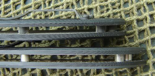

Closed shot
Liners
Backspacers

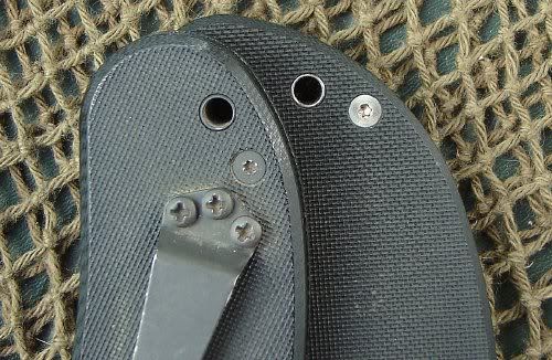

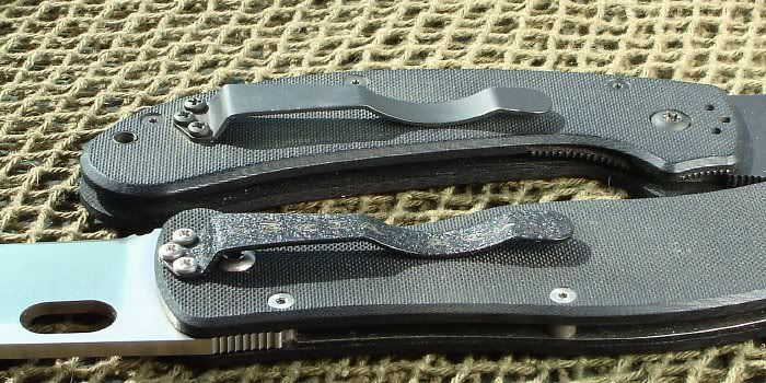

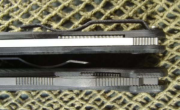

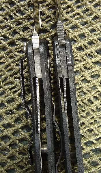

Same clips, G10 pattern & machining
Same imbedded liners
Same machining and blade thickness
Same pivot, clip screw holes, screws and choil
Same screws

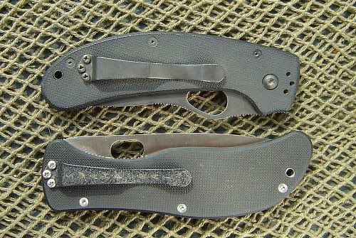

Open shot
