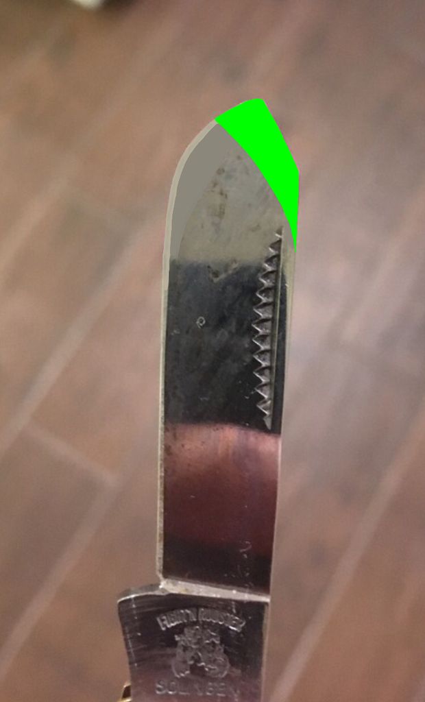

This would be the about shape I'm looking for.
I've never altered a blade like that, so I'm no expert, but I would definitely be worried about grinding away on the edge side of the blade. I would think it could mess with the flat grind on the blade and make it difficult to put a good, even edge on it again.
Here's the same image that I played with a little to give you an idea of how you could take material just off the spine and achieve a semi-pen-spearpoint (Zulu spear?) shape that would be pointier than the spay but avoid having to take anything off of the existing edge side of the blade. The green, of course, shows the material you would remove from the existing blade shape, and I colored in gray over the pink marks you had made to make it a little less visually confusing.
Not quite as pointy as what you proposed, but I would think it would be a lot easier than having to completely recreate an edge after grinding the existing one away.

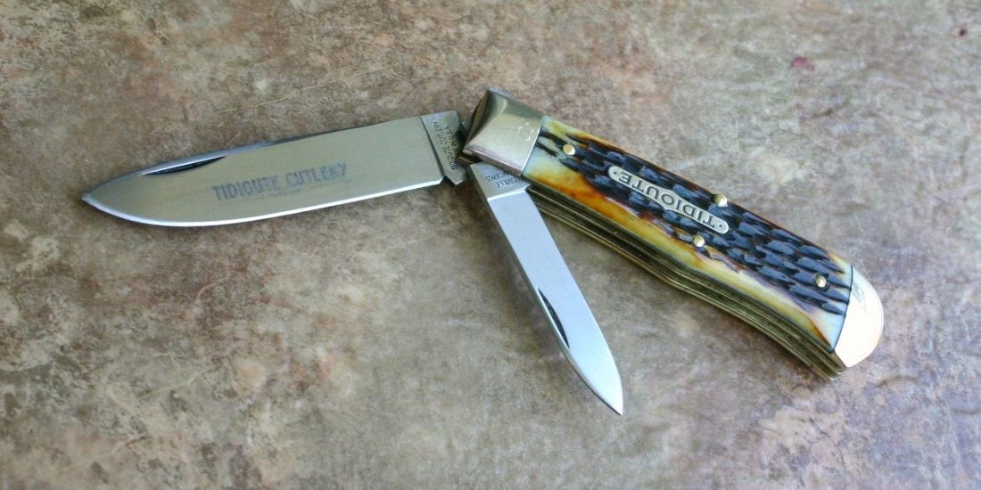

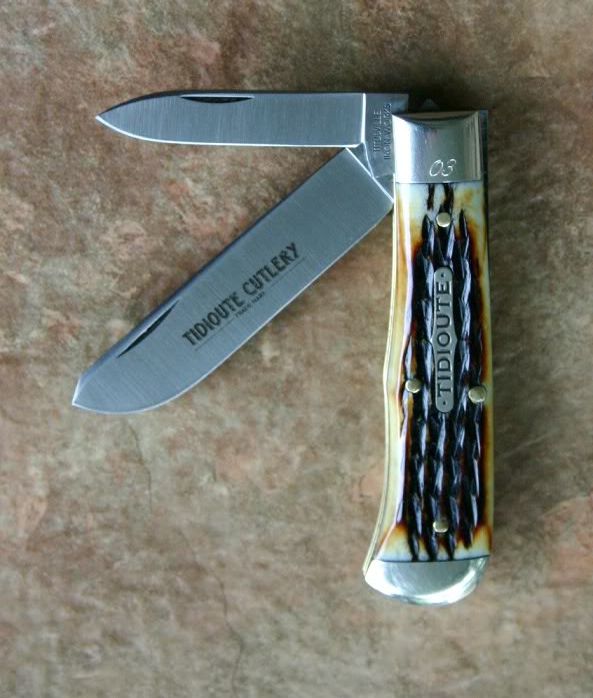

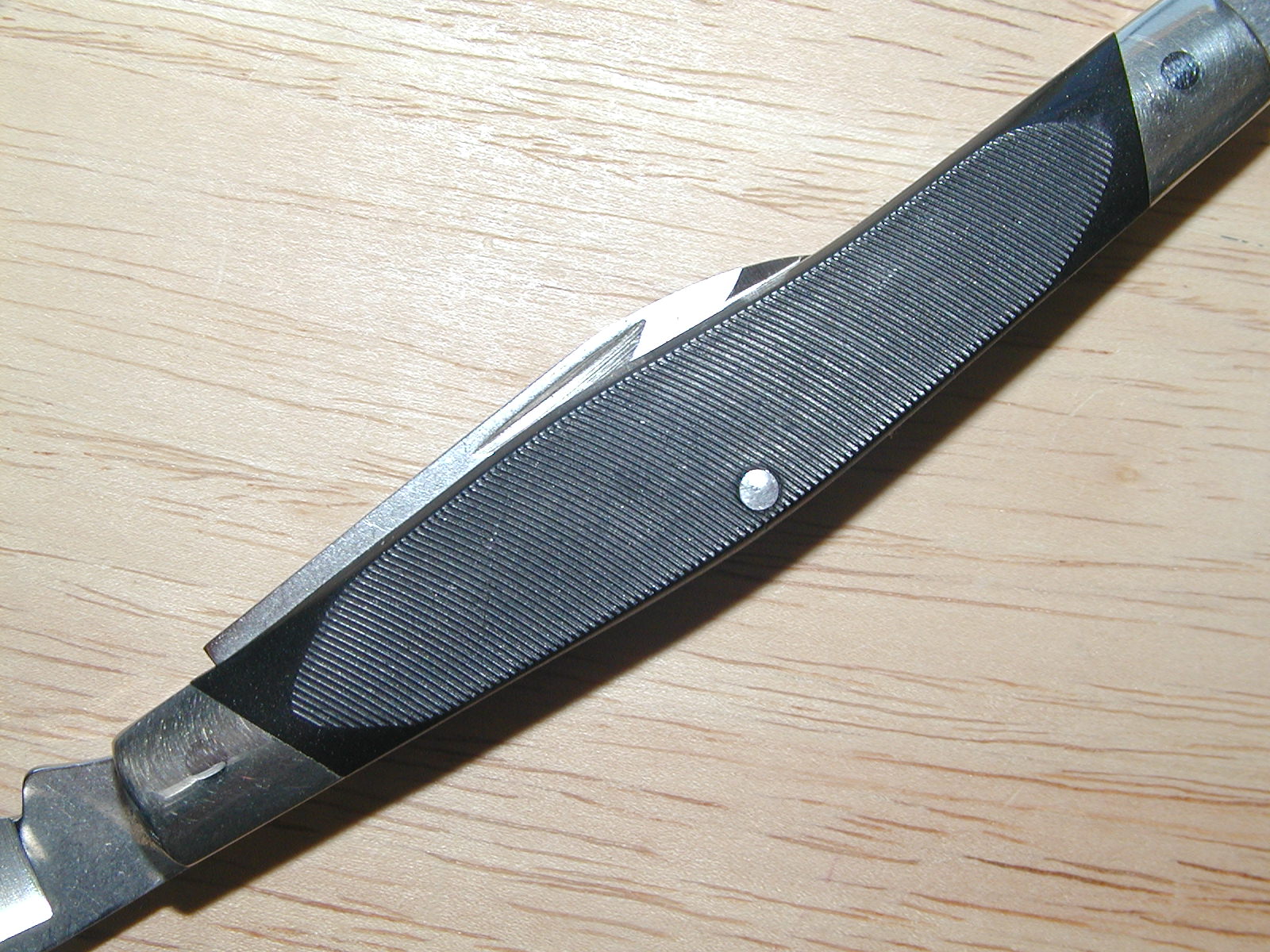

I did it to a 301. Just removed material from the spine. I also made the sheepfoot a bit pointier while I was at it.
Here's the other side that shows how close I got to the nail nick on the spey blade and how the sheepfoot sits in relation to the clip blade in the closed position.
It's not too hard to do. You just have to have a bit of patience and be careful not to overheat the tip.

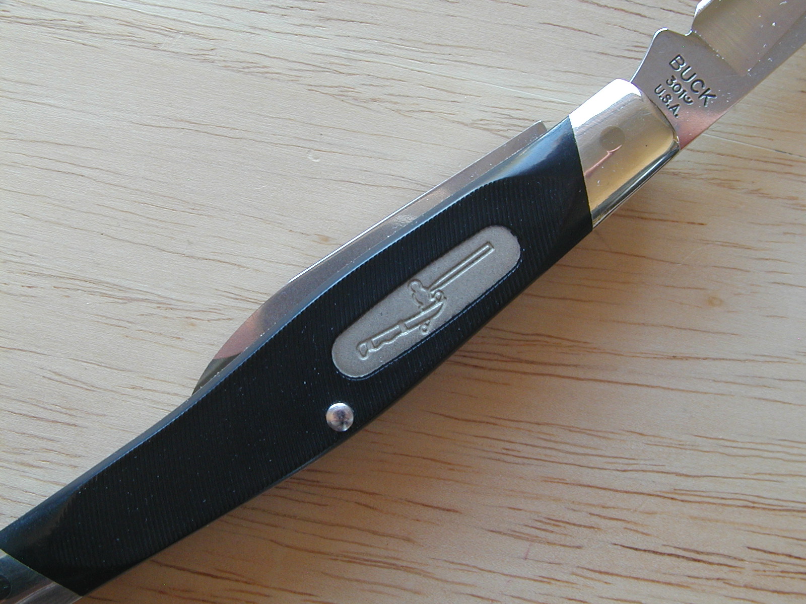

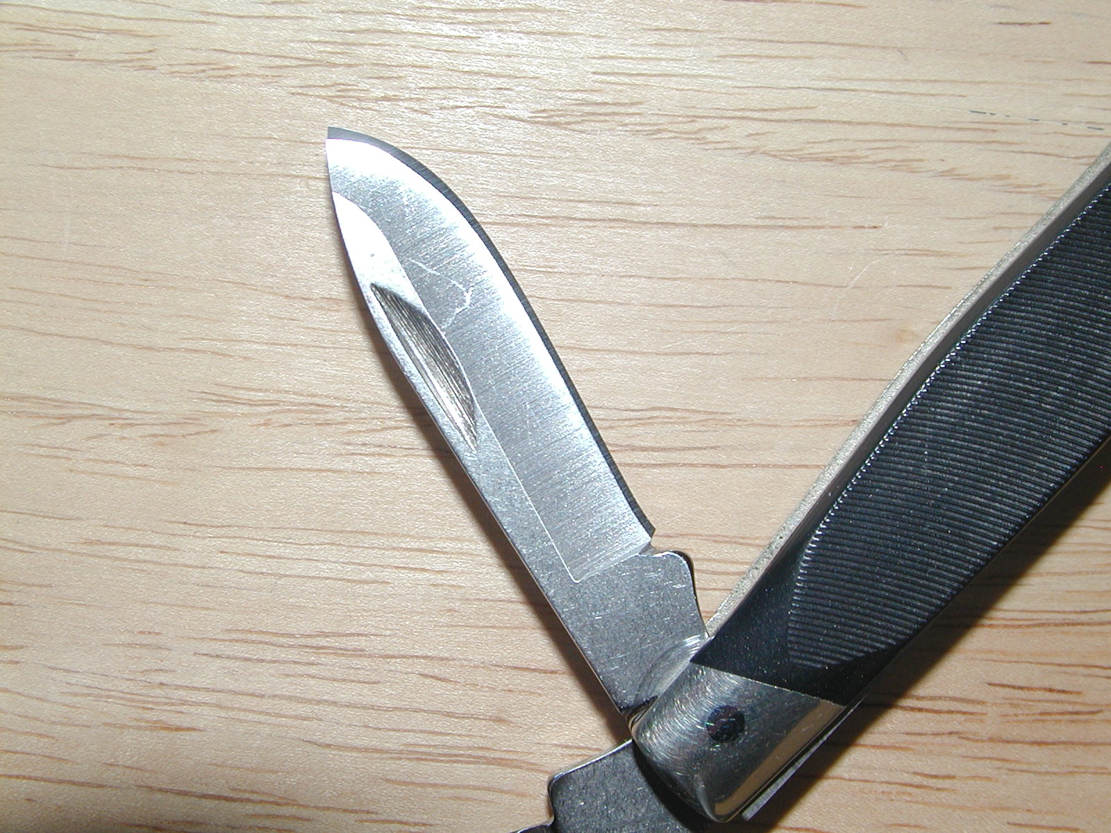

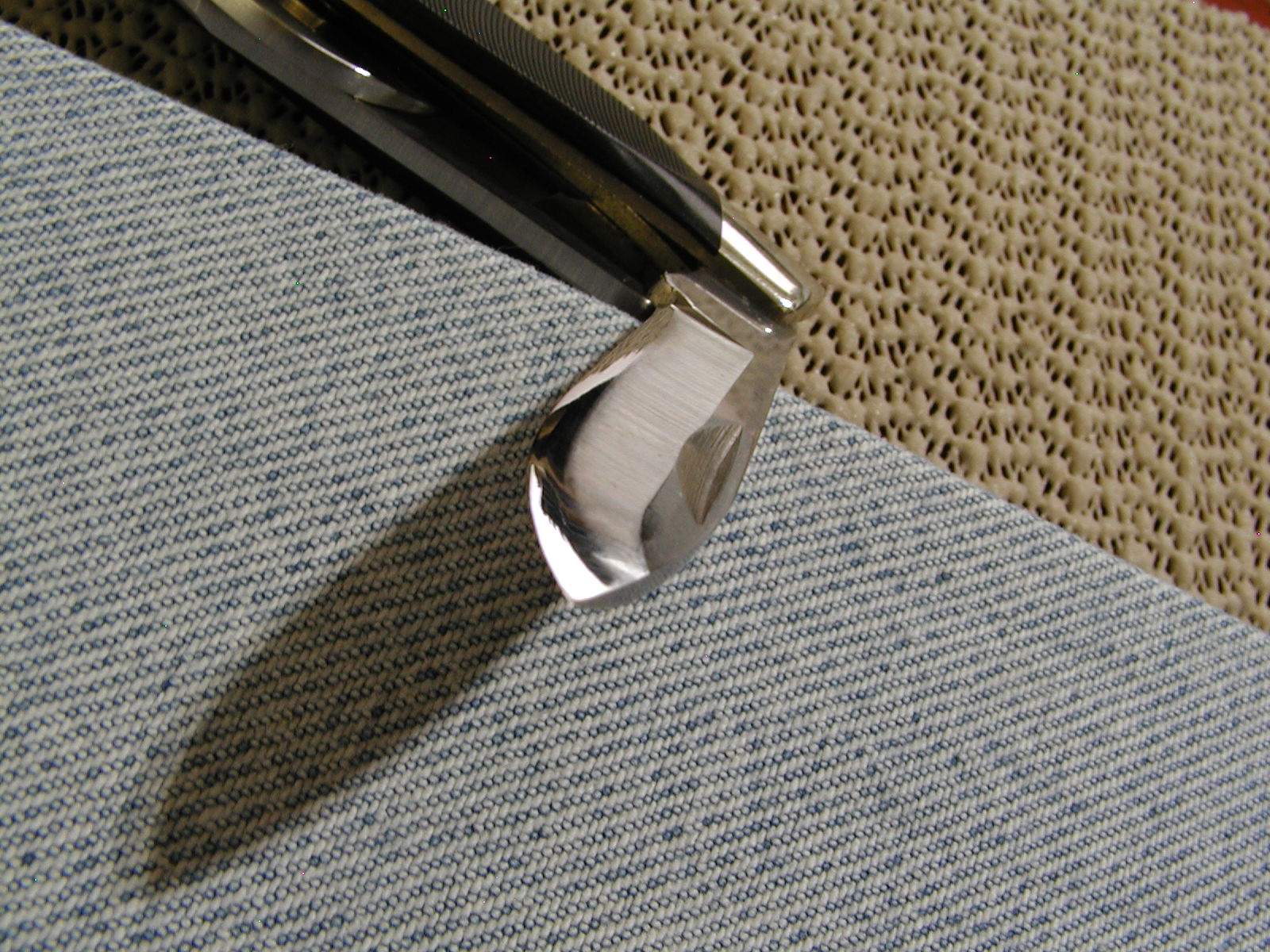

I reshaped my Buck 301's spey to more of a pen/spear profile. I used a 120-grit 3" x 21" zirconia-alumina sanding belt cut and glued flat to a 24" board. Drag the spine in a tip-trailing stroke along the length of the belt, starting relatively low-angle and gently raising the handle through the stroke to facilitate the curvature toward the tip; don't raise it too much. I used a wine cork stuck sideways onto the sharpened edge of the blade as a place to rest my index finger and exert pressure downward into the abrasive; that makes a pretty big difference in grinding speed, done with a little pressure. The 4th pic below shows some additional thinning, convexing & polishing of the edge, at some later time.
As mentioned earlier, I'd also NOT do much, if any, grinding on the edge-side of the blade. It removes thinner steel near the edge, which is of a waste of the best cutting geometry. Taking steel away from that side will only leave the (usually) thicker steel closer to the spine, assuming a taper from edge-to-spine, as most blades are ground. OR, at the least, don't take that steel right away. Sharpen it and use it for a while, then gradually move the edge back over time, during future sharpenings, IF you still think you absolutely must do that.

I've done a handful of these myself, and I agree about only grinding the spine. If you grind up the tip, you'll change the way the tip presents in the handle and may also have to grind down your kick. Not that that's a reason not to do it, and you may want to anyway. There are considerations if you want to drop the sheepsfoot to sit lower, and eo notches are an option, but now we're talkingredients about 4-5x the work.
It will also make for easier sharpening if you only grind the spine and not the edge, because then you have to set and blend a new bevel, and you're also introducing heat to the cutting edge, which, if you dip the blade in water between sander swipes, isn't a problem, and any overheated surface metal will sharpen off easily, but still.
I've done a handful of these myself, and I agree about only grinding the spine. If you grind up the tip, you'll change the way the tip presents in the handle and may also have to grind down your kick. Not that that's a reason not to do it, and you may want to anyway. But, it will also make for easier sharpening.
:thumbup:
That's another good point. The danger in taking too much from the edge side, especially if it also removes metal at the tip, is that the tip may no longer be fully concealed in the handle when the blade is closed. Hence the subsequent need to file down the kick to lower the tip which, in itself, can present new problems in it's own right (cutting edge too close to backspring, backspring 'dropping' below flush with liners, etc), and may still not be enough to hide the tip anyway.
