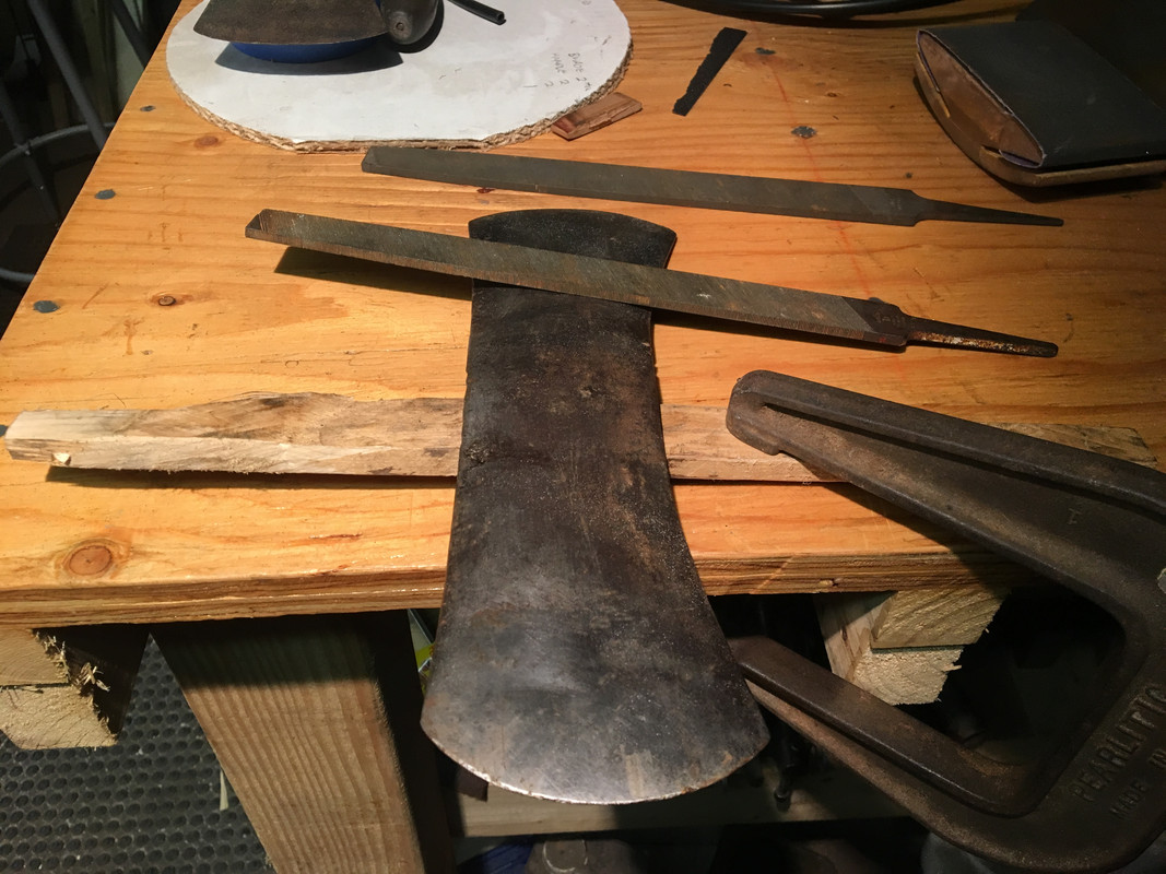

This is how I hold my axe heads when filling. Of course, at this point they have no handles. So just a simple piece of hardwood through the eye and C-clamped to the bench. And a Heller Bastard file and Nicholson Smooth file.

As I said, simple yet very effective. You should give it a try. Of course if the axe is already married to a handle, you will need the vise, but getting some practice licks in on just a head should help.
