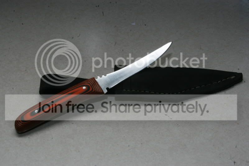

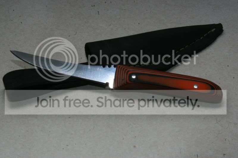

Couldn't stay away again tonight, and finally feel I have one or two worth sharing:
My take on a bird and trout in O-1:

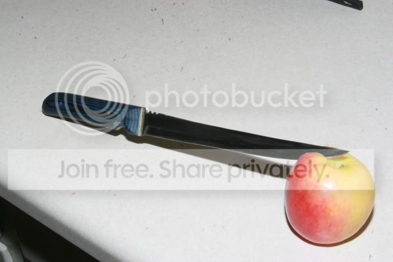

And a fillet I made for myself in S-35VN:
The apple was harmed in the making of pictures, but was tasty afterwards.
