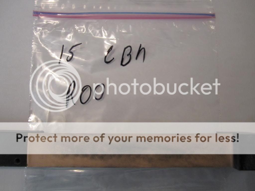

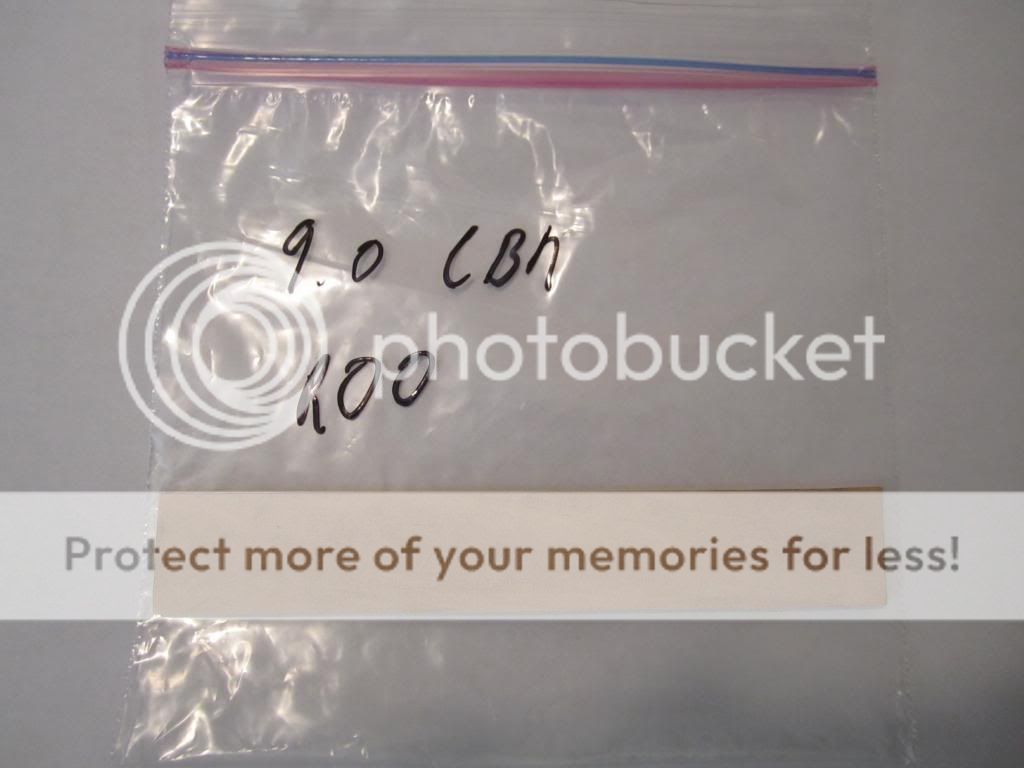

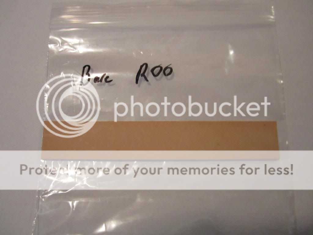

I have a brand new Cold Steel Warcraft Tanto (CPM 3V) , Factory edge , never used except to cut some paper for testing purposes. My goal was to see how a strop would affect this factory refined toothy edge. I suspect that cold steel finished this knife on some kind of coarse diamond belt. 600-800 maybe? Unlike traditional cold steel knives this one was not shaving sharp. Currently I've only been working the one side of the bevel just so I can look back on the factory bevel and compare.
So I grabbed my Kangaroo Leather Strop , and some 15micron CBN. This is all brand new stuff , never used. Applied the CBN in a sterile setting , and spread it using a sterile glove. (I had to change gloves several times as I was also applying my 9 , 4 and 2 micron CBN on separate strops). So now we have a clean strop loaded with nothing but 15micron CBN.
Took it to the EP and my new knife and started working on one side. Within 5 minutes I had formed a burr. Yes I formed a burr using a strop. The finish on this WC Tanto must be really quite coarse as even after significant work not all the factory scratches are removed. Im not chasing a mirror , nor am I even trying to sharpen the knife. Although the edge is improving significantly compared to the factory edge. FWIW , the 15micron is equal to about a 1k shapton , plenty toothy.
I think that its pretty evident that stropping is all about the compound , with the substrate playing a minor role* until you get to the really fine stuff where the abrasive in leather is actually coarser than the compound your trying to use (below 1/10th of a micron). A quality compound may cost more. But cost per use is much lower compared to cheap "compounds" and "improvised compounds". If you don't know what the abrasive is and how much of it your getting then don't buy it. Period.
Heres some pictures , these actually have very little to do with what I was talking about above , but they clearly show how much metal is being removed by a strop. Loaded with a quality compound. Ken Schwartz' CBN in this case.
Bare Roo
Compound applied (9Micron Here)
And compound applied and then used (the 15 and the 9 looked identical after being applied to the strop this merely illustrates metal being removed from the blade)
*So long as you are using a firm substrate with little give , and the substrate has an inherently finer natural abrasive than the compound being used. Such as Kangaroo Leather Balsa , or Nanocloth which has no abrasive until you load it , and will not affect an edge without a compound applied to it.
