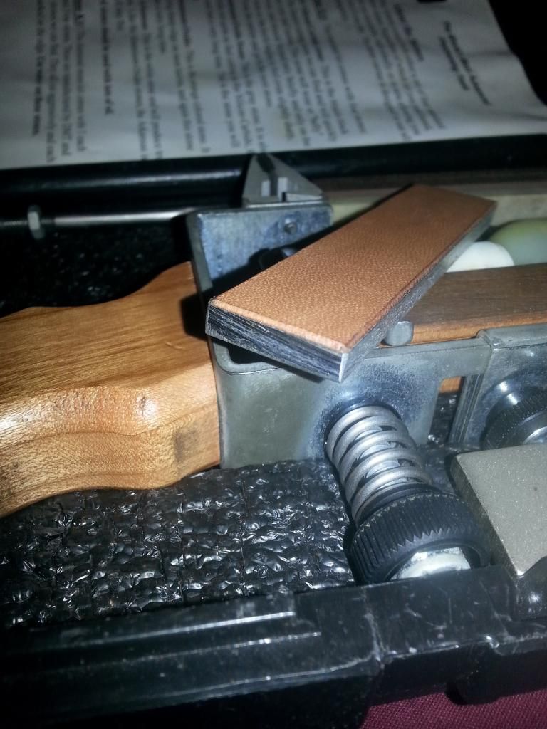

Thanks for sharing your knowledge about leather and leather treatment for strop makink Stitchawl,very informative.On a side note I just got a kangaroo leather strop for a KME guided sharpening rig.It is very thin and a fingernail does not dent it.
