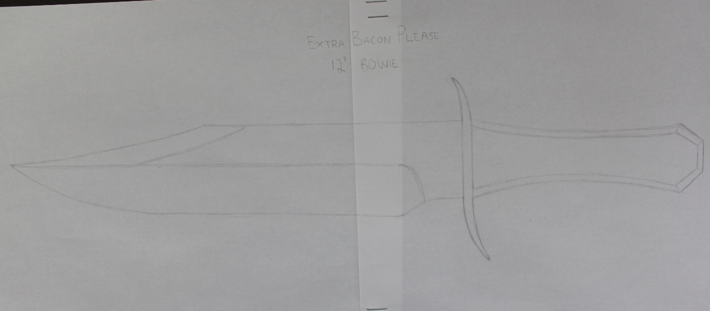

[Re titled] Designing 2 custom Bowie's to be built
So if you need or want to make any changes to the existing mods, post here and say it before you start doing them. I will check in BEFORE I start you current mods. If you post saying that you're making the mods, I'll wait till you post them.
Making a small revision to the 12" Bowie's handle and quite a few changes to the 7" Bowie.
Final revision for the 12" Bowie completed. Will post the 7" Bowie revisions when we finish off this 12" one. No need to muddy the waters.
Updated specs to follow.
Updates in bold.
Specs:
18" OAL
Blade:
12" blade
2.2" blade width (1" flat from the spine to the saber grind. 1.2" from the saber grind to the cutting edge)
1 7/8" blade width at the guard
5.5" clip point
6.5" flat spine
4.5" belly (with less abrupt belly, more slight curvature)
6" cutting edge
1.5" choil (1" flat, 0.5" on a 40 degree angle towards the cutting edge)
Handle:
Handle is now slightly asymmetrical - has a slight curve. (flatter [not flat] on the top, more curved on the bottom)
6" handle (including guard - guard is 7/8" thick)
1 3/8" handle width at the guard
1 3/4" handle width at the widest point of the coffin
1 1/4" handle width at the thinnest point of the coffin
the three lines that make the pommel/coffin are all 3/4 " long. Both of them are at 45 degree angles from the vertical one
1/8" or 1/4" chamfers along all edges of the handle - not sure yet.
Guard:
4.5" width (1" on the top of the spine/handle, 1.5" on the bottom)
7/8" thick
Pretty sure that's it.
Very likely the final design for the 12" blade Bowie;
I'm extremely happy with it.
I drew this to scale with one mistake, I drew the guard 1/4" too far forward into the blade. So the blade needs another 1/4" added to it in the flat spine/cutting edge to be to scale.
Also, while it is to scale, I don't believe it is actually straight from tip to butt. It's close but not perfect so some straightening up might be in need.

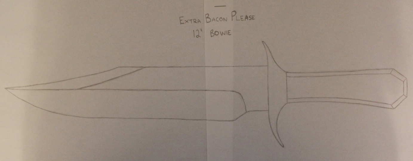

Specs:
18" OAL
Blade:
12" blade
5.5" clip point
6.5" flat spine
6" cutting edge
Handle:
6" handle (including guard - guard is 1/4 thick)
1 7/8" handle width at the guard
Guard:
4.5" wide (1" on the top of the spine/handle, 1.5" on the bottom)
1/4" thick
How's that for specs....that drained my life. At least it's done now :D
Why the S curve to the guard?
Let me know what you think Bacon, this is set to 100% scale.
I brought as many of your specs into line as possible with my graphics package, it's well balanced and on ball with what you wanted. I'll do the template file once I know you're happy with it.
My opinion isnt what matters at the end of the day, but personally I think that looks freakin awesome!! Easily the best of the designs so far.
Glad you like it Xtain. It's blade profile is similar to an Attack 14. :)
Because I like it.
I think it's the best one too. Your opinion does matter actually, everyone's does. That's why I made this in public, to get peoples opinions. If you want to share something or have any criticism - spit it out cause I want to hear it. Cheers!
Looks amazing. I'm very, very happy with it! May I ask how you know it's "well balanced". Thanks for all the help Coke, you're a legend.
