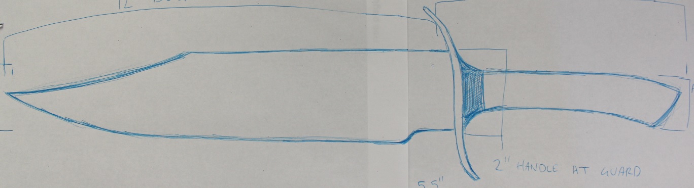

Here's what I'm thinking for the big one....
Specs read:
18" OAL
12" Blade
6" Handle
2 3/8" Wide Blade
2" Wide handle at guard
1 1/4" Wide handle near butt/pommel
5.5" Guard
Porpotions slightly out of whack in this pic as it was just a quick sketch.
Design is obviously not final. Still playing around with a few things, mainly the belly and clip point.
Cheers.

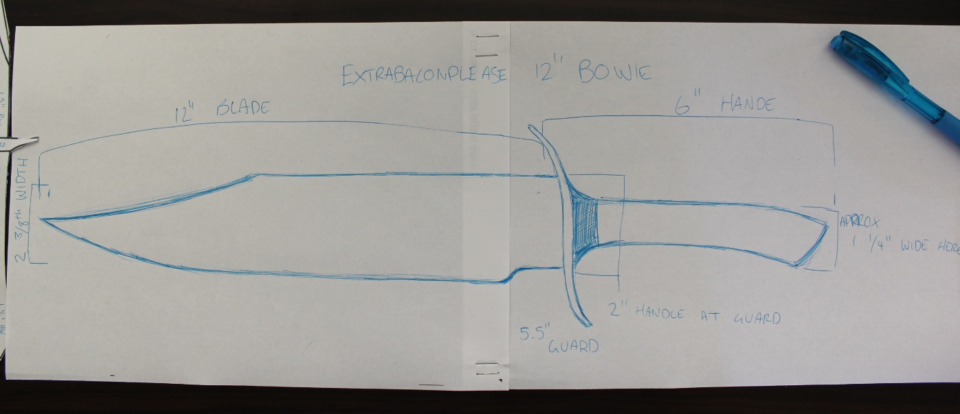

Preliminary sketch, your thoughts Bacon, and anyone elses are welcome before I go further on it.
12" Blade Bowie revised specs:
18" OAL
12" Blade
6" Handle
2" Blade Width
Approx 2" Handle Width with at guard (flared out from the handle)
1 1/4" Handle Width and near pommel
4 1/2" Guard
4" Belly
7" Flat cutting edge
1" Choil
5 1/2" Clip Point
6 1/2" Flat Spine
Hope that is coherent.

Give me a few to print it out, make adjustments etc etc Don't go any further on it mate, just to save yourself time.

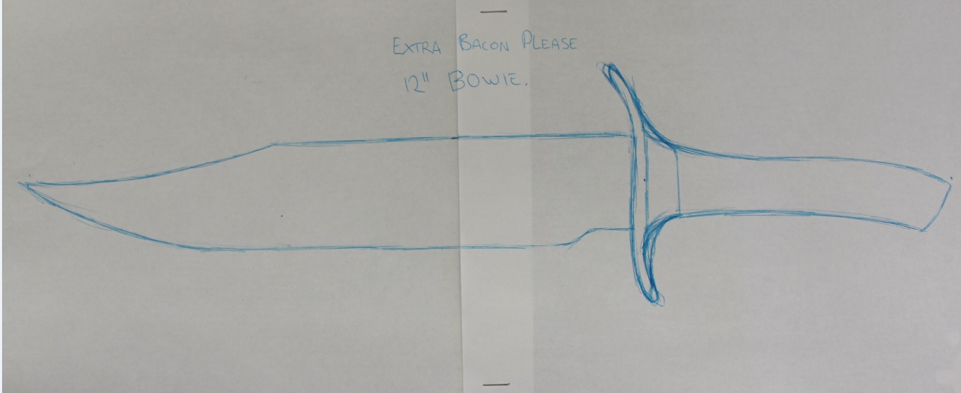

These pics are just for the basic profile, they are NOT TO SCALE. Which one of the 3 do you prefer? Then I can take it to scale.
