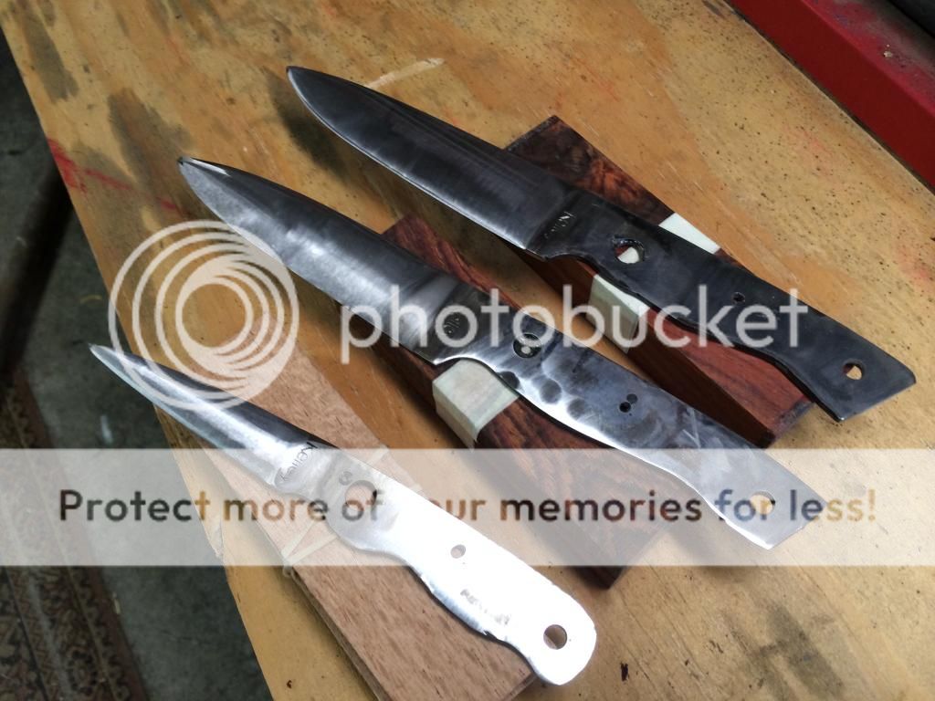

Well it's been a while since I updated this, but my first Damascus blades seem to be going OK.
This is them after initial grinding up to 600 grit, edges down to dime thickness, heat treated, and carbon mostly removed. Now some more grinding to finish the cleanup, ferric acid etching (that will be a new experience ;)) Cocobolo handles and final touches.
There is a story about the little guy that some may find amusing. I got all three of these blades out of half of an Alabama Damascus billet. The original plan was to get two blades and a bit of scrap metal. I wanted to use the scrap metal to heat treat first, etch first etc etc because I wanted to make as many mistakes on the scrap as I could and as few as possible on the two real knives. Then I actually managed to use the scrap for a little blade which was a reduced version of the two larger ones - about half size. Then there was an oops moment as I was grinding the little one (I think I looked out the window or something.) and I about destroyed it in two seconds. OK back to scrap not knife. But then I completely re-shaped it and who knows, it may yet be a usable knife. I think I will slim down the handle a bunch so it is in better proportion to the blade. Maybe one I'll use in the shop and hide when visitors are around? :D
Anyway guys I think this may actually work - etching is the big hurdle ahead - and many thanks to all of you who have given me guidance and even encouragement when I panicked earlier.

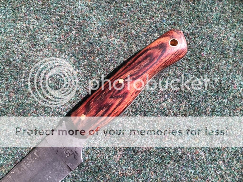

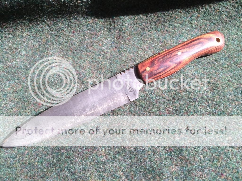

Well this is it - finished it yesterday for a good friend. I learned a lot along the way, benefited from a lot of good advice from members of BF and am actually pretty pleased with it for a first effort.
I am a little surprised at how dark the blade is - not as much contrast as some I have seen. I do not know if this shading is inherent in this particular piece of steel (the billet was quite dark to start with) or whether the shading is more related to my etching procedure. Any opinions about this?
It's a nice looking knife. It looks like you sanded or buffed it after etch. Etching is done very last. then it gets covered and a handle. Cause it doesn't take mu much to wipe it out. The only thing I do to the blade after etching and polishing is etch my mark once it is complete.
No, etching was the last step on the blade. Actually, the pattern is quite distinct on the blade, much more so than the pic shows - it's just that to my eye the pattern is grey on grey and I was expecting more like grey on silver. Etched in FC 1:1 with water. Too strong maybe? The pattern emerged very quickly.
First, for etching damascus, you want 3:1 or even 5:1 diluted FC.
Some mixes of steels don't show a huge color contrast.
It is too late now, but the best way to get bright contrast is to etch until there is a bit of "topography" to the pattern. You can feel it easily with your fingernail. Then, after etching, boil the blade for about 20-30 minutes in water with a Tbs. of baking soda or TSP. Once dried, wrap a piece of 1000-2000 grit paper around a solid backer ) steel bar) and gently work the surface. It will brighten the high spots and make a sharp contrast against the dark low spots. Clean and oil well after sanding. Don't assemble a damascus blade handle until everything else is done.
