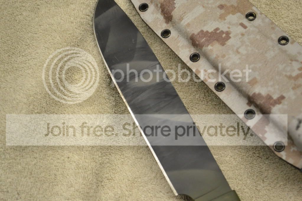

Hey man, to do digital give fishnets.or screen door material a try.
Do your base color, then pull the fishnets over the knive/area, or just lay the screen mesh over it. Hit it with a few random passes, some lighter some heavier, then go with another color and do it again in different/same spots. Comes out super nice, and WAYYY easier than those crappy little squares
Awesome work by the way! Love that 7
I am also wondering how you got the digital pattern? I seen dura oat techniques that use graph paper cut into stensiles & placed randomly on the surface with each color pass.
Good work by the way! Would love to get a necker done in a digital woodland once I finish convexing the blade.

That said, it's now time for pictures. Like I said, I started with Ontario knives, and did an SP50 that was used extensively in a class demoing how someone uses a knife in batonning. Seasoned ash and maple logs up to 9" in dia. were used, and students got to try it, so there was some lousy techniques. This would be hard on any coating process, and the following photos show the SP50 as it is today -- untouched after the class. The blade started out a dark grey base with tan streaks diagonally across the face (the tan in the photos is the DuraCoat, not wood remnants). You can get a pretty good idea of how it started out by looking at the tip and heel areas.
As you can see in the last shot, some of the tan coating "smeared", there are scratches evident, but the DuraCoat didn't flake or wear off. It's pretty strong stuff. Now how would the factory coating have survived the same abuse? My guess is "probably not as well". The factory coating, which I'm guessing is powder coat paint, resists the sandblaster to some extent, so I know it's relatively strong.
