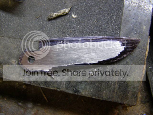

I appreciate all of the replies and help so far. My methods sound similiar to most of the ones posted, but I still don't think I'm getting dead flat. It shows when I put it on a plate that is guaranteed dead flat and to stay that way. I did take a few pictures to illustrate my problem a little better.
My method is craft bond the sandpaper to my granite plate
Use a magnet to hold the blade in the middle and sand in one direction only on the first grit of paper.
On the next grit I will sand in a different direction to make sure I get all the sanding marks out. I alternate directions with every grit change. I will do this until I have reached 600 grit sandpaper.
If I use nothing but the granite plate and sandpaper method I THINK I have it flat until I put it on the diamond plate and here is an example of what I find.
The black area is exaggerated, but it does not sand or polish while on a diamond plate. I can take that same piece and put it on any grit 60 through 600 grit and one or two swipes will knock the marker off and polish that area leaving me to believe the piece is flat because all previous grits and scratches are removed. But I can put it back on the diamond plate and it shows the edges are not truely flat. It makes me think the sandpaper rolls or bunches up not even enough to see with the eye in front of the edge as I push the piece across even though the entire sheet is bonded to the plate.

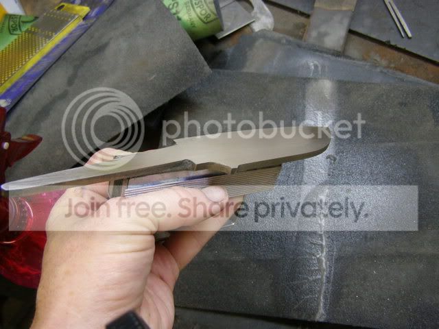

Here's a picture of my magnet

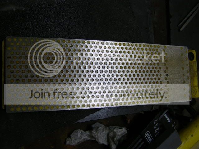

Here's the diamond plate

I would assume your granite surface plate is more accurate than a diamond sharpening hone.Perhaps the uneven grinding your seeing is caused by an irregular surface from the hone wearing differently at different spots.If the diamond hone had a very slight radius(bump in the center) it would cause a wear pattern like this.
That's what I was beginning to think too.
I think your process, Ryan, should result in as flat a surface as a human can make... I often end up with a small rounded area along the edges of ricasso and handle - very small, on the order of a 1/132" radius or less. I just grind it away until I get to the honestly flat part. It's not enough to change the dimensions of the knife in any way that matters for my work.

Thanks for the help guys. I called DMT before I ordered the stones to check on flatness. The duosharp (a new stone) I believe is what they are called are guaranteed a certain flatness I can't remember the number, but it wasn't anything more than the plate is guaranteed at. They also guaranteed it to not hollow or dip which is the whole reason I've been believing the diamond plate is the flat one and not the granite and sandpaper. It wouldn't be the first time I bought something that in no way holds true to its advertisement :o
