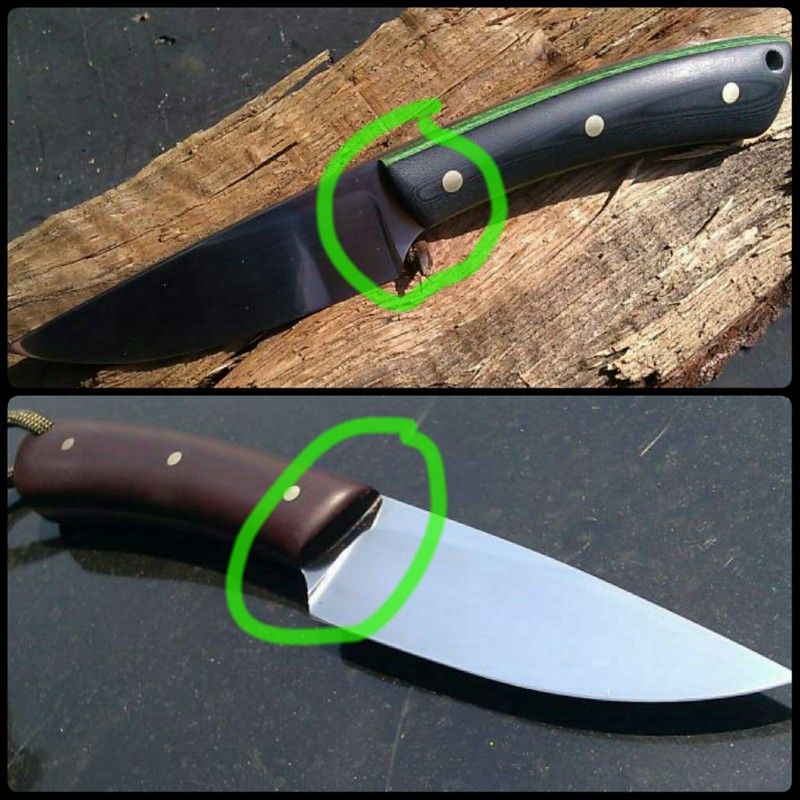

Reasons for sharp angle on front of handle scales?
Just to make this perfectly clear, here's a picture of a full tang knife. It can't be made with a one piece guard, because the hole in the guard would have to be so large to fit over the widest part of the tang at the butt that it would hang out above and below the ricasso.
Less than full tangs, like on the Randall 14 or Trailmaster, allow the maker to get the guard on - but they have to sacrifice tang dimensions to do it.
You can use multi-piece "guards", which we call bolsters, but they make the knife weaker because of the pin holes in the tang.
Not really. It's not that difficult to shape a bit of radius on the front of the scale after it's mounted to the blade, and achieve both a comfortable front and crisp "joint" where it meets the spine. You just have to exercise a bit of care to avoid scratching up the blade.
You can make whatever shape you want, before or after mounting the scales. After is just making it harder. My point was that you want the contour at the spine to match the contour mid bolster, or it is ugly.
The maker of the OP knife could have put any angle or contour they wanted on that scale. A curve takes only seconds longer to grind than a flat. It is an aesthetic choice, not some major manufacturing shortcut.
I'm speaking as someone who makes knives and makes scales for existing blades.
Im'm sure it is so the user can get his/her grip as close to the blade/edge as possible and still have some "meat" on the handle to grip. If it tapered down you would either have to grip the taper or the taper would cause space between your index finger and the edge causing unwanted leverage. If there is a finger choil that goes past the handle scales, a taper could be handy/comfortable depending on the overall design. In the case of the OP's pic I would guess that the maker chose the outcome solely based on aesthetics and crisp lines. A little masking tape on the blade tight up against the Micarta and very few light passes with a fine sandpaper will do the trick no prob.
Thanks for all the education guys. So most common answer seems to be it's very difficult to shape, as the shaping happens after the scales are permanently attached.

It's not that difficult. Just work by hand, with paper or file, & you will get a shape you want. think about it & keep reading until you know what you want. The hardest thing sometimes is to match a finish; sometimes best to refinish the whole handle. The worst mistake is to scratch the blade; protect with tape, & use the right tools. Be aware that some files have no teeth on the side, these are useful for this kind of work. Avoid power tools.
In a knife you obviously intend to use, a perfect finish won't last long, & you will end up refinishing or ignoring wear marks over time anyway.
It's only difficult to shape if you do it after the handle slabs are affixed in place.
After the pin holes are drilled and before the scales are epoxied into place is the time to shape the front of the handle.
Put the scales together and align them with the pins in place.
Shape away. When shaped and polished they can be affixed to the tang. No more work on them is necessary.
As to the square edges... it is way easier to square up and polish a square handle like that than it is to evenly contour the handle front and have it match side to side. Squared end is just a matter of pushing the blocks against the platen. Done & off to polish.
The pins would have to be re-fit precisely, almost impossible.
Its not hard to hit that edge with a file or a slack belt toward the end of the handle shaping. That's what I do. Your pic looks like a brkt, and I'm surprised by the squareness of their handles in general. Its an extra step, and requires a little hand finishing followup to match.

respectfully Daizee, I'm gonna argue with ya on this one... I've come do do most of my slab style utility type blades this way and if I can get it to work, it's far from impossible. I use sacrificial pins and a couple dabs of crazy glue to get the slabs where I want em for rough sanding, then once they are close I take the knife apart and use the pins to just hold the scales together while I do some of the radiuses and whatnot before gluing and screwing the whole mess together. I find it way easier than going around after with files and sandpaper trying to not scratch something by mistake

I'd have to disagree with a couple of your points... at least with my limited ability it does take longer, whether it's seconds for you or 20 minutes for me to get the shoulder of the scales to match evenly without scratching the blade finish or handle material by mistake. so I'm not 100% sure you are correct that for everyone else it's an asthetic choice. If it is, it's quite possibly a poor one from a user's stand point in that every sharp edge can become an irritant if this blade gets used much. Not to pick on you, but your other post about making it perfectly clear what a full tang knife looks like is a bit of a misnomer and leaves a bit of wiggle room. This is what ONE type of full tang knife looks like... there are many ways to skin a cat and bark river doesn't hold the patent on full tang and many of those ways can easily accept a guard or rounded handle slabs, bolsters or whatever the imagination and innovation can create.

If you're doing your shaping of the front of the scale with it not mounted to the blade, and you have the two scales taped together, the process is very fast, regardless of the shape. Doing it on the knife is doing it the wrong way.

Apologies, my mistake for not describing enough. I only meant that some light rounding (photo below) would help some for comfort. Not enough to change one's firm purchase on the handle.
I'm so glad you joined this discussion daizee. I want to post this photo example of your knives, which shows exactly what I believe knives should have from a comfort stand point: light contouring of that hard angle at the front of the scales. Your knives make me question why all knife makers don't do the same.

RX is totally right about shaping the FRONTS of the scales before they are affixed to the blade. However, since I don't know what the final contours will be before gluing, I reserve breaking those forward edges until I'm about to do the finish sanding, which is all by hand.
Personally, I don't do any to-tang shaping with the scales off the knife (except rough bandsaw cuts). I find it to be too much messing around with parts back and forth. I use a slack belt on my 1x42 to break those edges usually, but it could also be done during the hand-sanding step with the blade chucked into the vise. As soon as the glue is set, I tape up the entire blade anyway to avoid minor bumps - of course major bumps are always a risk...
