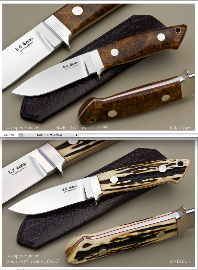

Reasons for sharp angle on front of handle scales?
I'm not an authority figure, I'm not peeved, and there is no smack-downery involved here.
Thanks for sharing your work; looks good from here. Keep at it.
It's cheaper to leave them for most production purposes as it would add time, money, and hands to finish appropriately.

It is actually fairly easy to run a tool around the outside during the machining process, I'm surprised to see so many that leave it sharp. For example this G10 scale has a fillet all around, it's easiest to see from the top view, it breaks that sharp edge nicely. You can also do a chamfer or radius family easily.

You're making my point. The ones you have pictured with one piece guards have tangs that are much smaller than the blade/ricasso and they do it with a 90 shoulder that the guard butts up against. The handles end up being normal size because the blades are so wide.
I can't speak for Bob Loveless, but I'm 99% certain that the guard in that picture is made with two pinned bolsters. The grinding hides the seams and pins, blending them into what looks like one piece. A fine way to do it, but like putting shoulder on the tang, the bolster pin holes sacrifice some strength.
Here's a really classy way of doing it:
On this Schrade, the raised guard is part of the blade. It was likely forged that way. Blade makers don't do this very often because you either have to start with 1/2" flat stock that is the width of the guard and grind all of the blade and handle area down to the final blade width, or forge it, which is not fun. You can see the really nice curved transition from the side of the blade to guard, avoiding every kind of stress riser. It is hard to imagine a stronger design.
The current fashion in the bushcraft/combat/survival world are full width tang knives with the top of the blade and handle in a straight line, and the edge/lower handle pretty close to. They tend to avoid having a lot of holes close to the blade. (BRK, Survive, Becker, Rat, ESEE, Enzo, Busse, etc.) All that is done for strength because choppers and batoning is so fashionable. That kind of knife shape is near impossible to put a one piece guard on, and bolsters are relatively weak because of the holes and the interruption of the scale.
I'm sure many people could make some arguments about what "full tang" means, but I was observing that the Randall 14's tang is no larger or stronger than other stick tangs - it is just a stick tang that is exposed on the top surface rather than being hidden in the center of the handle.
While not considered a full tang, Randall 14's channel tang construction is stronger than a typical stick tang. The tang is 1/4" thick x 7/8" wide. The reason behind this design is to keep the tang as wide as possible while allowing the handle material to remain in one piece, thus eliminating the risk of handle slabs cracking off.
Technically, Randall only makes one full tang knife and that is the Model 10. In this case, the handle slabs are tapered as they transition to the blade.

Very true... knives with the blade narrower than the front of the handle look a little weird to me, though. But it definitely works.
For you forgers... If my info and memory is correct, many of the classic "California bowies" from the 1800's were made with straight full tangs, had the guards fitted, then the tangs were forged again to give them the shape/taper they wanted...
... thus, a full tang, hilted blade with a butt wider than the front of the handle. I find that style very aesthetically pleasing.
One way to put a double guard on a full-tang knife is simply to cut the profile with a lower guard as you normally would, and "wrap" a slotted piece of (whatever) around it from the top. So it's pinned/soldered like a two-piece bolster, but it's one piece that has a solid projection on the spine side as well.
Or of course, just start with a wider bar and cut both upper and lower guards into it.
(that's not my work obviously, just an example I found on the web) You could easily put bolsters on a piece like that.
...That's why "full tang" is usually defined by the fact that the tang runs to the top and bottom of the scales, as well as the full length. A Randall 14 does not, and is arguably less strong through the handle than a knife of the same dimensions, but with steel running to the top AND bottom of the scales.

Furthermore, one-piece guards on a full exposed tang knife (most Loveless-style drop-point hunters feature this, along with a tapered tang:
It seems to me that the squared off corners is a result of leaving more handle material up front to aid grip and prevent the hand from moving forward onto the blade. The same way a guard would have prevented that from happening. Contouring it would seem to help force the hand forward onto the blade in harder use situations.
