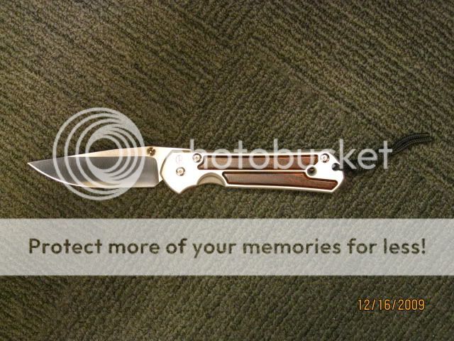

Hey all,
Last week I received a new small limited edition 2008 sebenza with a satinwood inlay after ordering it 4 weeks ago from one of the renowned CR dealers in the US. Took a long time, with no communication about the shipping status from the dealer (even after asking a couple of times).
The blade is a beautiful addition to my growing CR collection. Perfect centering of the blade, beautiful color of the inlay, a joy to behold. Wow, I even made myself an unboxing video to be able to have another look at it later and remember the joy of seeing it the first time.
after a happy couple of minutes I found out that it was actually pretty dull, not even cutting paper, let alone shaving hair, and that the grinding was way (yes wayyyy) off.
I was totally not expecting this, especially after my earlier experiences with CR knives.
After checking out the edges under my loupe and doing some careful experiments with the sharpmaker and a magic marker, I found out that one side of the edge was ground at about 20 degrees (even takeaway of the marker ink along the straight portion of the blade) and at a steeper angle on the tip, not sure exactly how much. The other side of the edge was a little over 15. The edge did not look perfectly centered to me.
:confused::confused::confused: Yes, that's a 5 degree difference:confused::confused::eek:
Now, before I will be misinterpreted: I love CRK and own a couple and use them a lot. I know the quality is excellent and they have very good QC, at least, that is my experience so far.
But this knife's edge looked like it was ground by the local town drunk ...
Also, I saw that the lanyard was fixed through the hole, while in my other LE small seb (the only other small one I own) there is a metal thinggie (just like in the large sebs), a spacer with a hole in it that is made for the lanyard to go through.
Now, I'm not sure if that's normal, or maybe the LE 2008 had this, but I was now on the point of wondering if 'something' happened to it. Was this a new knife? Where was the spacer with the hole for the lanyard?
I couldn't see any use marks anywhere so I let that thought slide even though I'm still unsure of this...
After having thought about it for a while, I decided to do a rebevel on the knife making it 15 degrees per side.
I had just succesfully reprofiled my emerson horseman the day before on my japanese waterstones (took away the chisel grind and I like it better btw), but did not want to use my waterstones on the new seb as I'm not good enough to really get a precision angle on the knife and I also didn't want to make a slip up an scratch the whole blade.
So I went to the only other sharpening system I own: the spyderco sharpmaker.
I love it, use it for touchups and have all the stones for it (diamond, coarse, fine, ultra fine). I did a rebevel on a dull new benchmade griptilian before (154CM steel, the first dull factory edge I got) and it took me some time but pulled it of within a reasonable time, I guess about an hour or so. It's a long process and I know there are faster ways, but don't own an edgepro (yet?). Also the sandpaper trick on the rods of the sharpmaker are a bit risky if you don't want to damage the blade finish.
So after thinking it through another time, I put the steel to the diamond rods at 30 degrees (15 per side) and started at it. I've doing it for about two hours now and am almost there. the middle of the curved portion to the tip does not yet see the edge coming together, but I think it needs another half hour and I'm done with the diamond rods. The tip is proving to difficult so far. Then I will start with the next stones, which will of course need much less time to do.
I feel a little p1ssed 0ff about it... It's a very expensive knife, a limited edition and I had to rebevel it because the sharpening was bad...
Not only that, but I guess it's incomplete (during this post I double checked my other small sebenza for the lanyard spacer). I like to sharpen and I like playing with my knives and making them my own, but I would at least have liked to play around a little bit with a normally functioning knife before taking this drastic step. A lot of the pleasure is spoiled right now.
Did anyone of you have a similar experience?
What are your thoughts on this?
How about the 30 degree angle?
what about the lanyard spacer, should it be on there?
Is there any consolation for me? :)

I'm sorry to hear that. That's dissapointing for sure.
I don't know what your shipping situation is or how much it would cost you but CRK will resharpen and rebevel it for you to a thinner angle if you can send it in. My next reccomendation would be get a DMT aligner kit because it's easy, it will keep the angle for you, has all the stones needed for reprofiling and it will do it much quicker than sharpmaker.
A 30 inclusive should be fine.
before this turns into a bashing thread have you contacted CRK?... as for the tie bar those started showing up in '09 so it would not have come on your knife. also keep in mind that your sharpener is a sharpmaker not a profilemaker and will not work effectively for that
with the diamond rods it will reprofile relatively easily.

Shipping costs and missing the knife make it verrrry unatractive for me to send it back to CR. I'm totally confident they would help me out though.
Yes, I have them and am using them. Relative is the key word, over 2.5 hours right now.

- Yeah, that's nicely put, it drove me crazy for a little while...
- sounds like a plausible explanation, I experience the same when I'm freehanding, especially when pushing one edge and drawing the other.
- wavy grind, thanks, that's the explanation I was searching for, didn't put it in words but you obviously picked it out
- in my experience the diamonds do cut somewhat quicker than the brown ones
- thanks for pointing that out dude, it's the little pieces of knowledge you share here that I really like about your posts
- that's correct. It falls out of the umnumzaan, but it stays in my small sebenza LE 2009, so it's an upgrade I assume. the LE is somewhat newer than the ummie.

thanks olddude, especially the part about tip sharpening is good to know. This actually does not account for the 'wavy grind' in my case. I'll be sure not to wear the tip out to much (although I'm going there already, I have noticed it but I'm not taking of the tip or making it a lot thinner)

rebeveling/reprofiling is easy in terms of the process, but yes, it is very time consuming.
crk customer service is exellent, ive called for a variety of things, and have always been met with very polite and helpful responses.
You could have that blade rebeveled/reprofiled in a half hour if you have the DMT aligner kit with the extra extra coarse stone depending on the angle you're trying to use.
