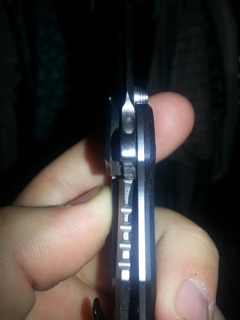

Just wondering, is this too much lockup? Is this something that can be adjusted?
This is the main thing with liner locks and frame locks that people go nuts over. That is awesome lockup. I have seen locks get like this and not move for years. I say keep it and use the crap out of it with the knowledge that it will most likely never fail you.
As long as the lock bar is not touching the opposite side scale and the lock up is solid nothing to worry about.
Hmm, OK. It's never touched, I just see a lot of knives where people talk about having 50% or so lockup and mine is always more than that.

It's not a pain to unlock but I feel like the lockbar is dragging on the blade when it opens, causing it to be slower than the it could be.
Probably shouldn't mess with it though. It's not a problem, per se, just something I thought I'd ask about. My extra parts from ZT should be in this week and I'm looking forward to cleaning it out real well and getting it set up just right.
Mine is about the same lockup. It had me worried for about 2 seconds, then I proceeded to use the hell out of it. No issues, hasn't moved since, and could care less if it does with the warranty. I'm gonna go until she blows.

First you can see if the lock bar is the problem. When the knife is open place a wedge between the lock bar and the opposite side (frame). Now the blade should move freely and by itself. This is a good time to adjust the pivot screw. After this adjustment you can try opening the blade normally. If it doesn't open easy you have a lock bar or centering problem. If the blade is not rubbing the side it's likely the lock bar. Make sure that you are not applying pressure with your fingers when opening. I found that in the tip up position the clip applied too much pressure on the lock bar. If you find this bend the clip until you can slide a piece of paper under it.
