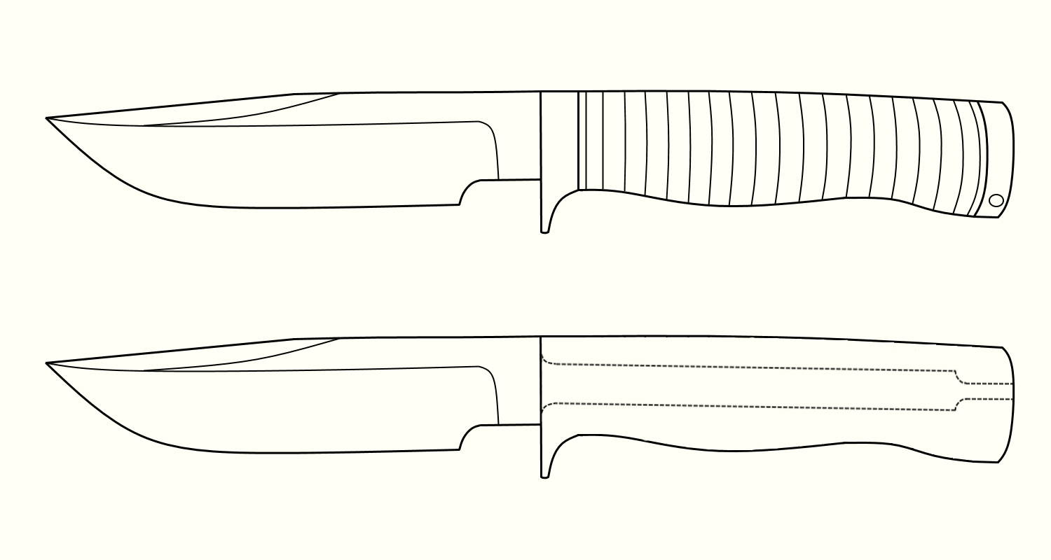

So, Im considering sending these sketches off to a maker.
Its my first knife design, so Im interested to know if I messed anything up. Specifically the design of the tang; too wide, too narrow? I have no idea what the tang in a stacked leather handle is supposed to look like. I took care to round the shoulders tho.
Its very clearly inspired by the Model 5, but fixes some problems I had with the design, such as pulling up the sabre grind & thinning the blade stock. Im planning to have it done in a subtle hollow grind. Not sure about jimping yet, probably yes.
The measurements seem a bit wonky, but thats only because of the 119mm blade. 12cm is max in Germany for legal carry, so it has to be just a tad under. Theres obviously some tolerance.
Also not so sure about the stock thickness. I dont know if makers nowadays still do distal tapered blades & whether or not it costs a load extra. Ill be discussing these things with the maker whenever I decide to commit.
