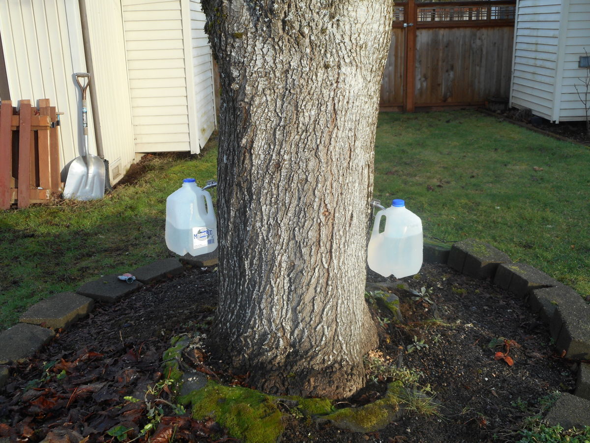

We're going back and forth between damp and freeze. But we're not getting dumped on like the rest of the NW. And it's actually pretty good maple syruping weather.
You guys are killing me with bare ground, green grass and you even have sap running. That is just unreal. We are getting hammered. Brutal winter.
