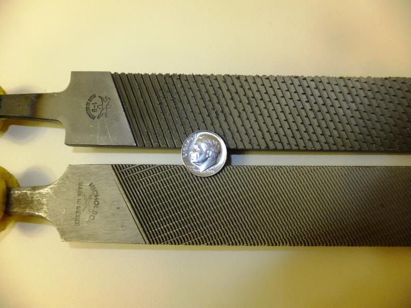

Late to the party, picked up a 12" Nicholson single cut mill bastard file at Home Depot, cuts very poorly compared to my rusted out old 8" Heller.
got a sweet pfred, course 12" its huge and really moves the material
pfred next to the nicholson. nicholson isnt bad, but man the pferd is just way better.

For radius plunges, I like chainsaw sharpening files. They're not tapered like a round file. Do you mind if I ask which Pferd that is? A model number would be even more helpful. I don't think that "1-B" mark is the model....something else.

My appologies, Phillip. I indeed meant to direct my inquiry to mjderstine. Is that a Pferd chip breaker? Or is that a Pferd double cut bastard? Thanks!!!
It's neither the Chip Breaker nor double cut bastard. The Pferd Chip Breaker (I have one) would look virtually identical to the Simonds Multi-Kut. The double cut bastard would have teeth finer than the Chip Breaker. The Pferd pictured in mjderstine's post looks like their version of a vixen file, but with chip breaking grooves cut in to prevent the teeth getting clogged.
Mjderstine, where did you buy that Pferd, if I may ask.
When I went of Pferd's website, they have a file called a "babbit" file. The teeth in that black and white rendering look exactly like the teeth on mjderstines picture. Very aggressive looking teeth. You're right, grapevine, the Pferd chipbreakers look very similar to the Simmonds multicut....with that diamond pattern thing. And Pferd's double cut bastard doesn't look as aggressive as this pic shows. Hence my question.....which Pferd file is pictured next to that Nicholson.....and a model number would be most helpful. Me want one!
What they call the Babbit file is a milled tooth file, of which the vixen files are a subcategory of. The vixen files tend to have curved teeth and are sometimes called curve milled tooth file. Nicholson and some other manufacturers also have a version of the vixen but with offset curve that they call Super Shear. The milled tooth files tend to be used in the auto industry on softer metals for body work, or in woodworking for really rapid but smooth removal. I've wondered how well they would do on annealed steel, so it's good to hear that mjderstine had good results doing that.
Here is a picture of the side of the file that I'm wondering about. The aggressive teeth caught my attention, but after closer examination, it looks like a few of those teeth have been knocked off completely. Hmmmmmmm...... I'm REALLY curious now as to what that file is.
I would definitely think that this file is indeed a babbit file, or a vixen type as mentioned by Grapevine. I'm not familiar with either, hence the curiosity. Looking at the side profile, I could see how this would be a "curve milled tooth file".
OK, after sleeping on this, I think I'm wrong in that last statement. The photo above is not a curved mill tooth file. A curved mill tooth file's rows of teeth are actually arranged in an arc shape, instead of straight lines. I was thinking "curved mill tooth", and looking at the side profile of the picture, and thinking, "those look like the teeth of a shark.....curved". Like Grapevine said, a curved tooth mill file is like a vixen, which the above file is not.
However, back to the "babbit file"....this is what Pferd's website shows as being a babbit file, and it's teeth are most certainly not curved. This black and white looks exactly like what mjderstine has.
After MORE research, I think I've found the culprit. Model number 13003. Amazon.com $29.87. It is Pferd's babbitt file part number, listed in Amazon as a chip breaker. Can be used for softer metals, and annealed tool steels. By the looks of those broken teeth, I would say annealed tool steel is pushing it a bit, I don't know. I ordered one from Amazon as well, should be here middle of next week. I'm anxious to try it out.

As an update to the Pferd chipbreaker.......I HIGHLY recommend this beast to anyone wishing to use a file to remove steel fast. There is nothing else like it!!!! The teeth are indeed huge, but they are sharp...and these germans must know their heat treat!!! That file has been through many bevels already....still shaving steel off like no body's business. Highly highly recommended for knife makers!!!! Makes magi cut and multi kut look like smooth cut files!!!

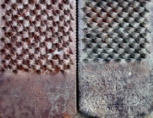

For big chunks of softer non ferrous metals, the most aggressive tool I've used is an old farrier's rasp. Wow does it chew through brass and aluminum- twice as fast as my big angle grinder with a coarse disc. I have to wrap a rag around the end to keep it from chewing up my left hand. It's a very coarse one, kinda like the one pictured on the left here:
It's too rough for wood, unless you have like an inch of material to remove, since it tears out the fibers so aggressively.
