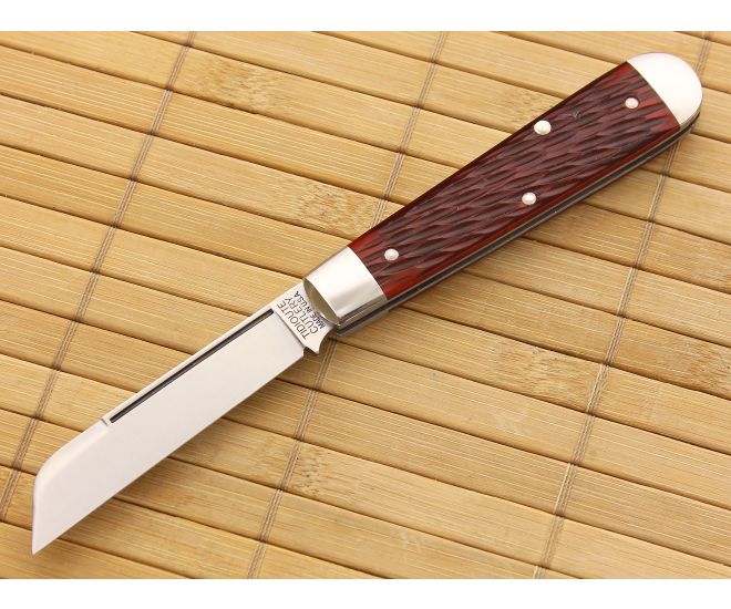

Some examples:
Front to back, no swedge, swedge about half-way back, short swedge just at the tip, and swedge all the way
Gotta say, the way they did the swedge all the way on the GEC version is my favorite. Just looks so sweet.
