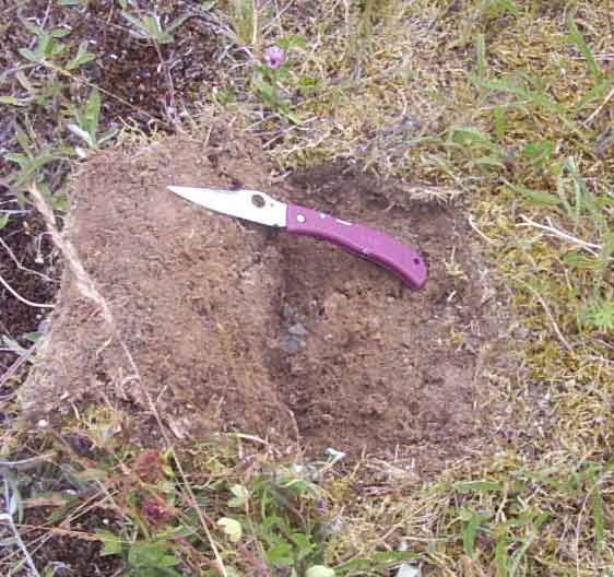

Edge was blunted, but the secondary bevel was still present under magnification so no signficant damage. I was more irritated than the knife because there was an ant's nest under the sod which didn't take kindly to me removing their roof.
-Cliff
