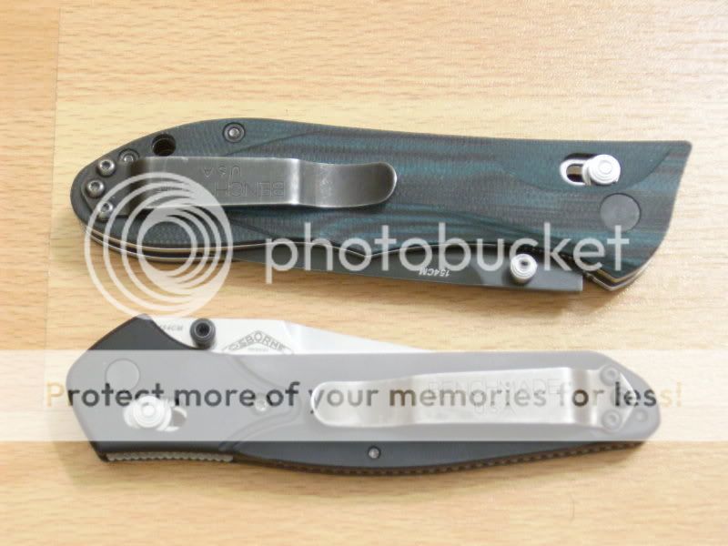

I agree with the any lock can fail statements, but for me it's .....
