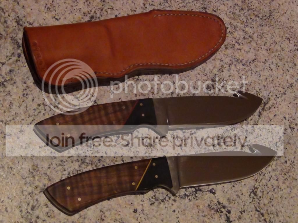

I made these two as a order came in from one bloke and wanted one for his best hunting friend. Most people imo, that like them have never learnt to harvest game with a smaller sharp knife.
