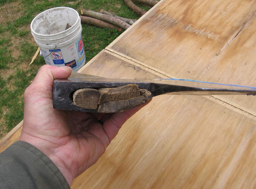

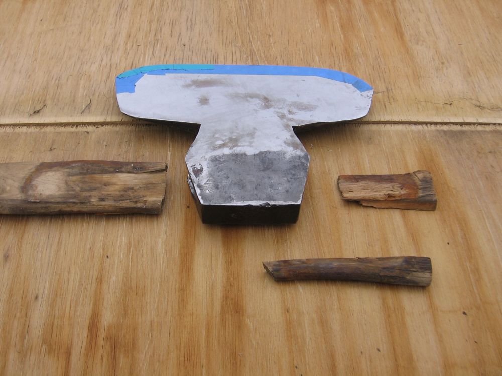

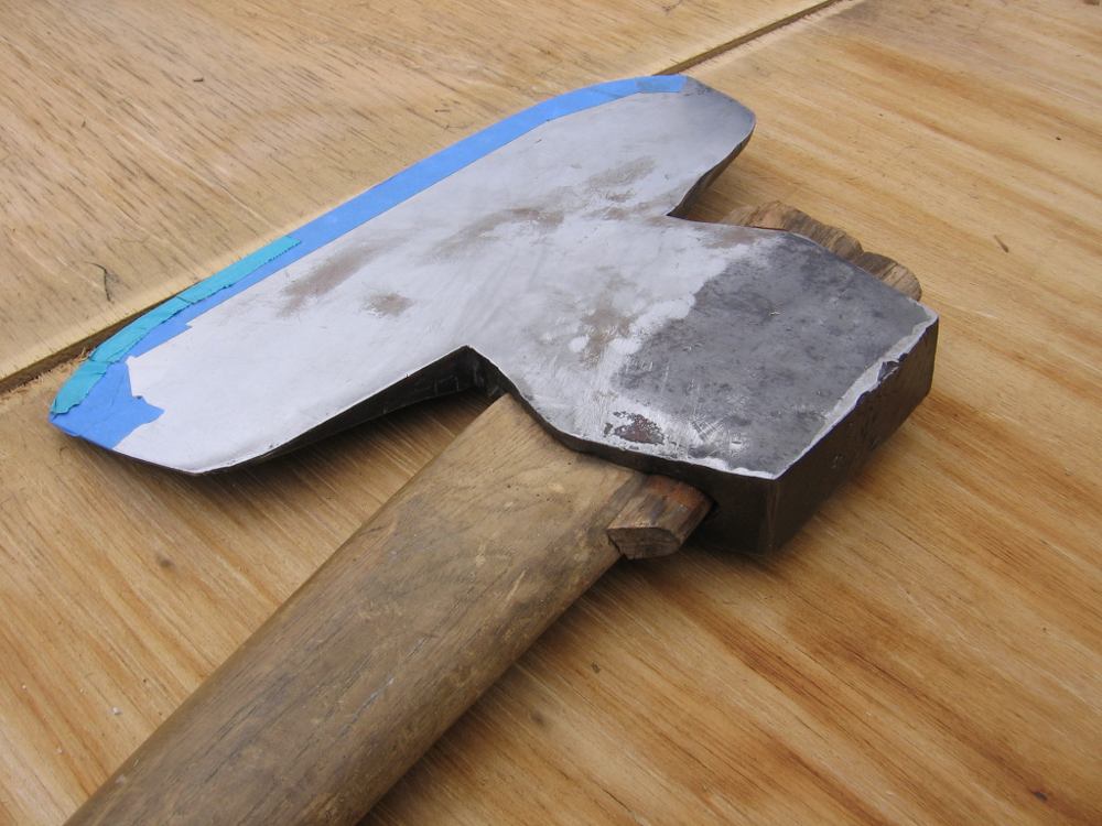

I discovered this system on a broadaxe I purchased a few years ago. I'm guessing that the previous owner had a second handle for this broadaxe which allowed hafting it with the bevel reversed from right to left. That's a handy thing and was likely the reason that some old boy came up with this. Here's the system as it came on that old broadaxe. This axe was solid as hung with this system.
So the previous owner could remove this haft and insert another one through the top of the eye and thereby change the handing of his broadaxe.

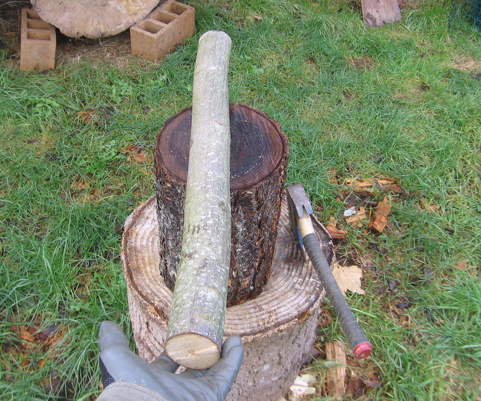

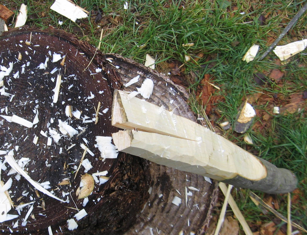

So I started with this, a branch of big leaf maple which I dragged home a couple weeks ago.
Right away it split on me when I started to carve it. But since this was just to demonstrate the system I continued on. Hey, in the wilderness you may have no choice but to carry on.

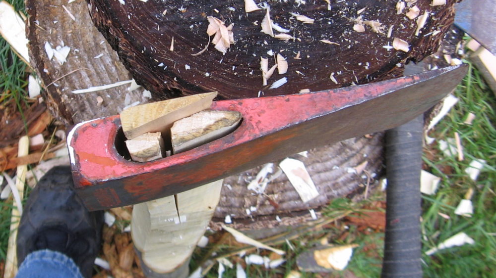

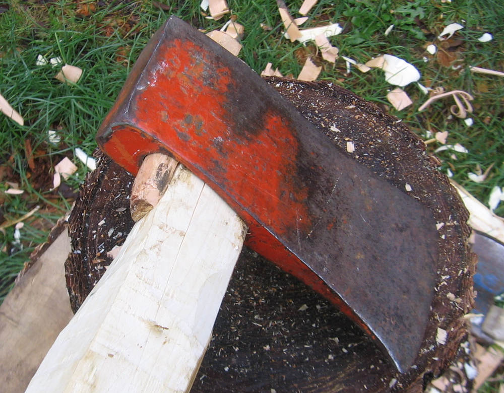

Here I've shaved off part of the handle to make room for what I call the side wedge. I'll also have to take off some material for the back wedge.

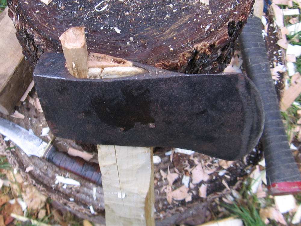

It's important that the side wedge sticks further back than the handle. Imagine if this haft wasn't split. The side wedge would protrude 1/4" further toward the poll than the haft does. The back wedge will force the side wedge over the haft causing the side wedge to fill the eye side-to-side.
Here I've started work on the back wedge. Note how it pushes the side wedge over the haft.

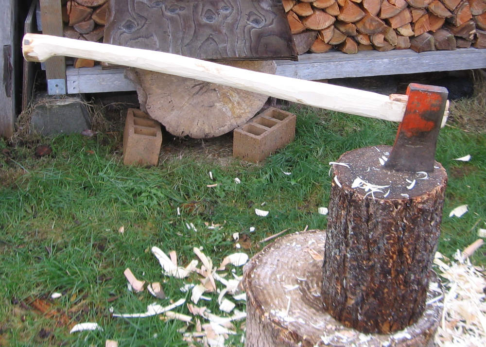

With the back wedge in I could swing this axe now. At this point I've got 25 minutes into carving this handle and wedge system.

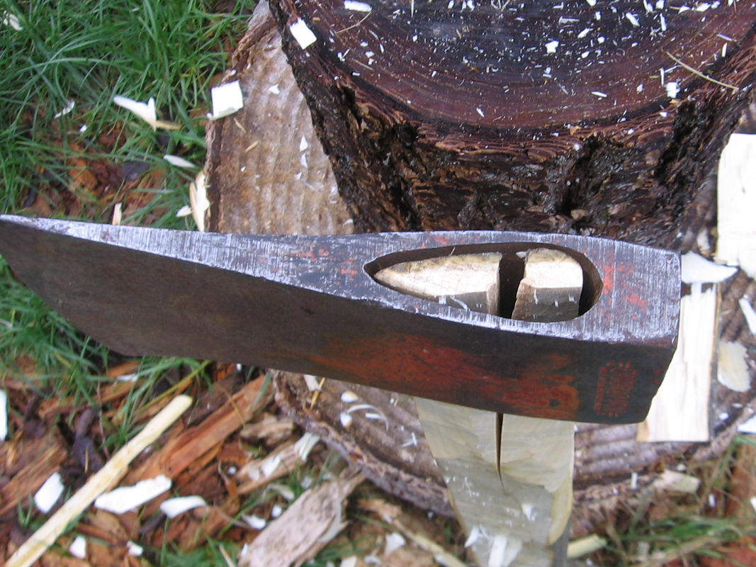

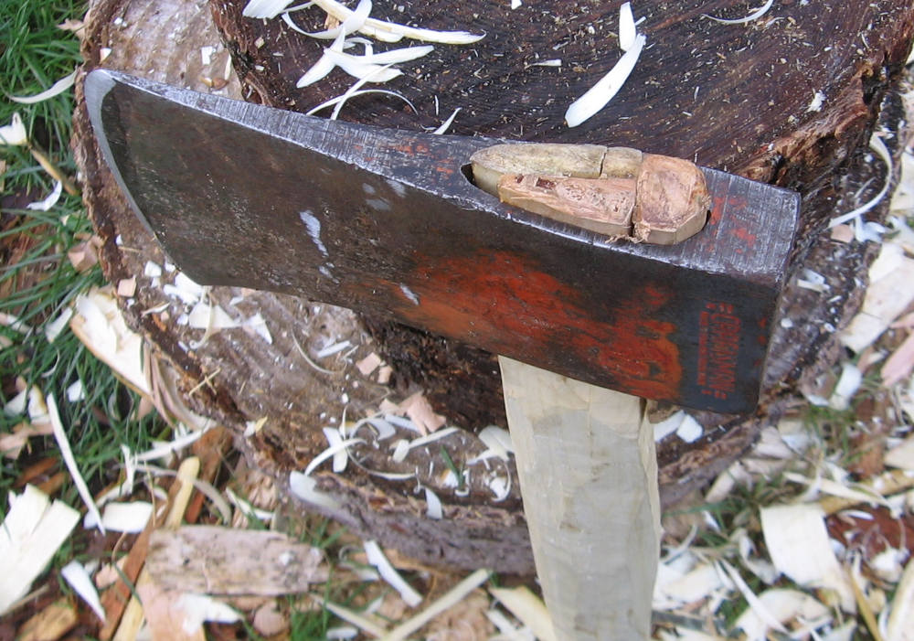

A bottom view of the wedged axe.
Another 25 minutes of whittling and I have a functional axe. I did a little chopping and splitting with it to make sure it worked.
I pounded the wedges in a little further after use. I might have to re-wedge it once the green handle dries.

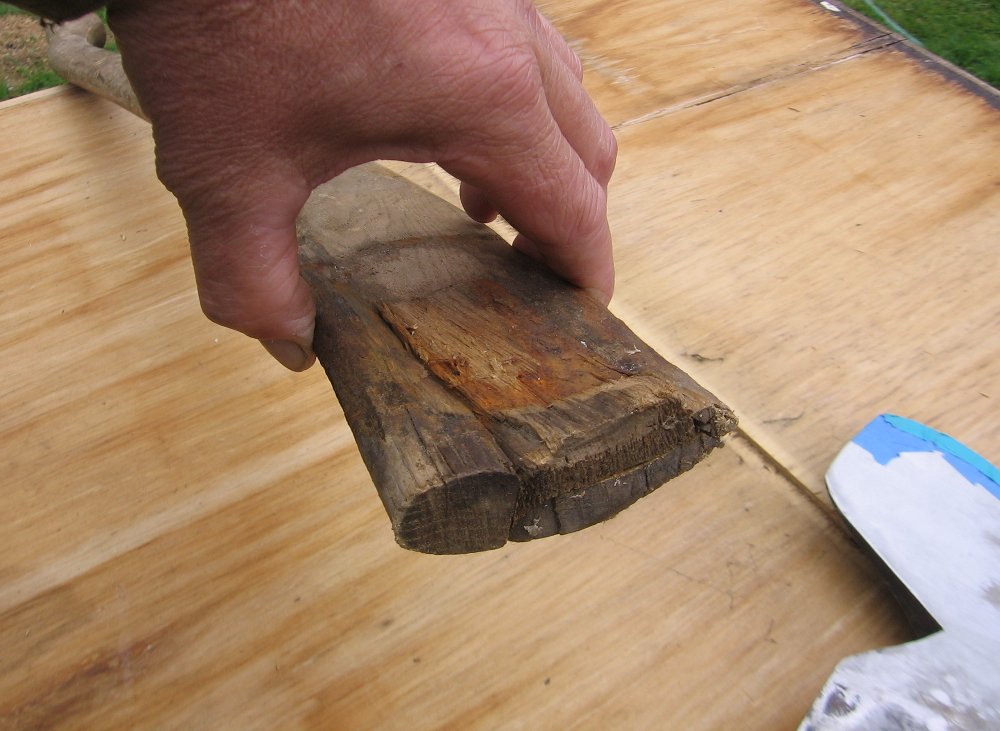

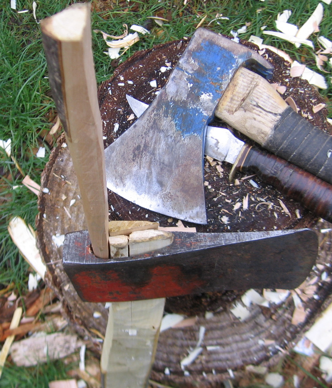

Here I've pulled the haft off the first head and put it on another head. I switched it back later.

If you had a folding saw you could make the traditional center kerf for the center wedge and then add the back wedge. I'm thinking I would do it this way if I had a folding saw along. The brilliance of the back wedge is being able to undersize the haft both ways and then wedge it tight. This makes it a whole lot faster to make a handle this way than with a slip joint system where you need to shape the whole handle to slip through the eye. If you start out with an axe wedged this way for trekking you could potentially remove and reuse the wedges with a new handle making the process even easier.
