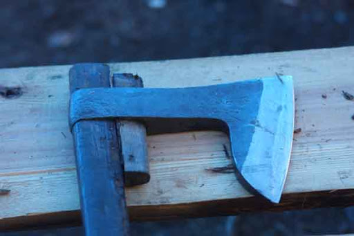

Removable wedging system for axes
Leave it to Steve to have examples, and pictures, and SAWILCO-marked versions on hand. I guess with the SAWil you pry up the tab until enough of the keyhole slot shows to get a screwdriver pry blade in it. Definitely any of these make for reversible 'field tightening repairs' instead of pounding in old keys, nails, screws and mower blade tips.

i have been using wedges which are a little proud of the eye so i can remove the handle. i do this because i make handles and test different wood and handle designs. being able to remove the handles is convenient.

i'm going to give your system a try. i have a few old heads to work with.
buzz
Here are a couple photos:
A tapered steel removing wedge would work well to pull that out. The deep slot would allow the removing wedge to be driven in until the original wedge had been lifted an inch or so.
