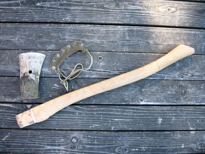

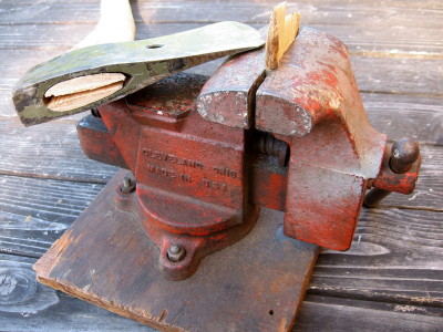

Peter Vido taught me this way to remove (or tighten) an axe head. Maybe this info will be useful to some others.

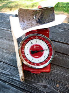

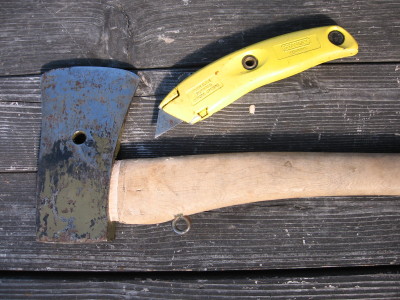

This Swedish military "hand axe" had a good handle, but the head needed a little work, and I wanted to see how much the head actually weighed.

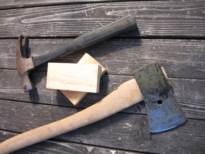

It's easier if the head is slightly loose and a couple good chops will raise it a little, say 1/16", exposing the tiny "shelf" that the head normally rests on. The idea is to lower this shelf by 1/4". Using a knife, I scored a line around the handle, 1/4" below the old shelf line, and carefully removed wood above the scored line, to match the dimensions of the eye.
I then put the axe head on the ground, with the metal supported by wood blocks, and tapped the bottom of the handle with a hammer until the head was seated on the new shelf. This resulted in the top of the handle extending out of the axe head by 1/4".

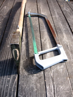

With a saw, the two sides of the handle are cut flush with the top of the head, while the wedge is left uncut.
I clamped the protruding wedge into a vise and yanked the axe straight up, and with some luck the wedge stayed in the vise.
In this case, there was no metal wedge, which makes the job easier. A similar approach can be used if there's a metal wedge, with some extra work with pliers, perhaps after modifying the protruding metal wedge with a hacksaw, to get a better grip.
Lowering the head a little bit, as shown, before pounding an existing wedge in some more, can also be a good way to tighten up a loose head.

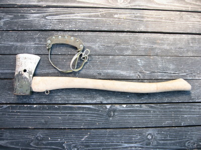

Postscript:

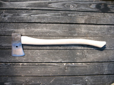

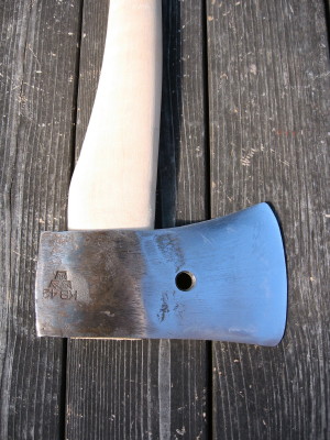

The cleaned-up head back on the cleaned-up handle:
More info about this axe here.

I have done that also. Side tip, if you have a metal wedge in there, you can take a small small drill bit and drill beside the metal wedge, just enough to properly fit a pair of needle nose firmly around that wedge. This will let you "work" it a little more. This seems to work ok, unless for some reason you really need the wedge.

I've used this method about 4 or 5 times now, without a hitch (although I didn't have any gnarly metal wedges to deal with).

The one I did had two little hatchet wedges in it, but I was able to chisel around them and get them out with my vise and a jerk or two.
